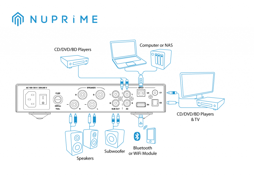

•   State-of-the-art DAC supporting USB PCM 384 and DSD256, also capable of decoding DoP formats via coaxial and optical inputs
•   Analog line-out (Sub Out), with twice the standard output power, provides impressive lows and a wide sound stage specifically designed for subwoofers
•   Extension port for Bluetooth dongle and WiFi audio streaming (optional)

Inputs:
1 x USB PCM / DSD Digital (PCM up to 384kHz & DSD up to DSD256 )
1 x Coaxial Digital S/PDIF (PCM up to 192K supporting DoP format DSD64)
1 x Optical Digital S/PDIF (PCM up to 192K supporting DoP format DSD64)
1 x Bluetooth or WiFi (optional receiver) module.
1 x Analog Stereo RCA
Outputs:
1 x stereo RCA (designed for subwoofer with twice the standard power output)
1 x stereo speaker (binding posts) output

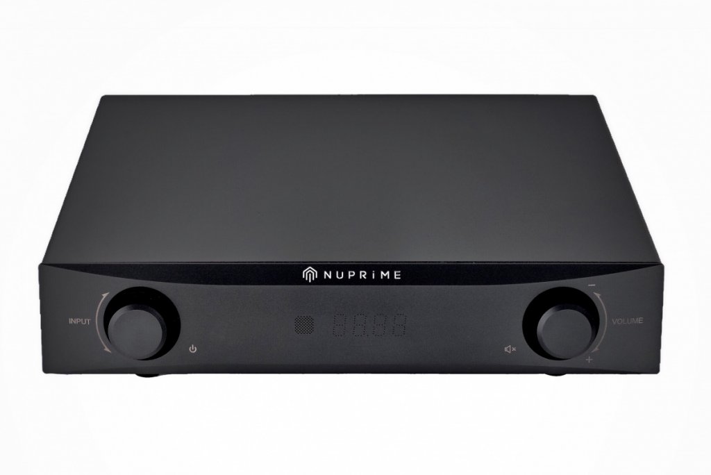

Pics?
