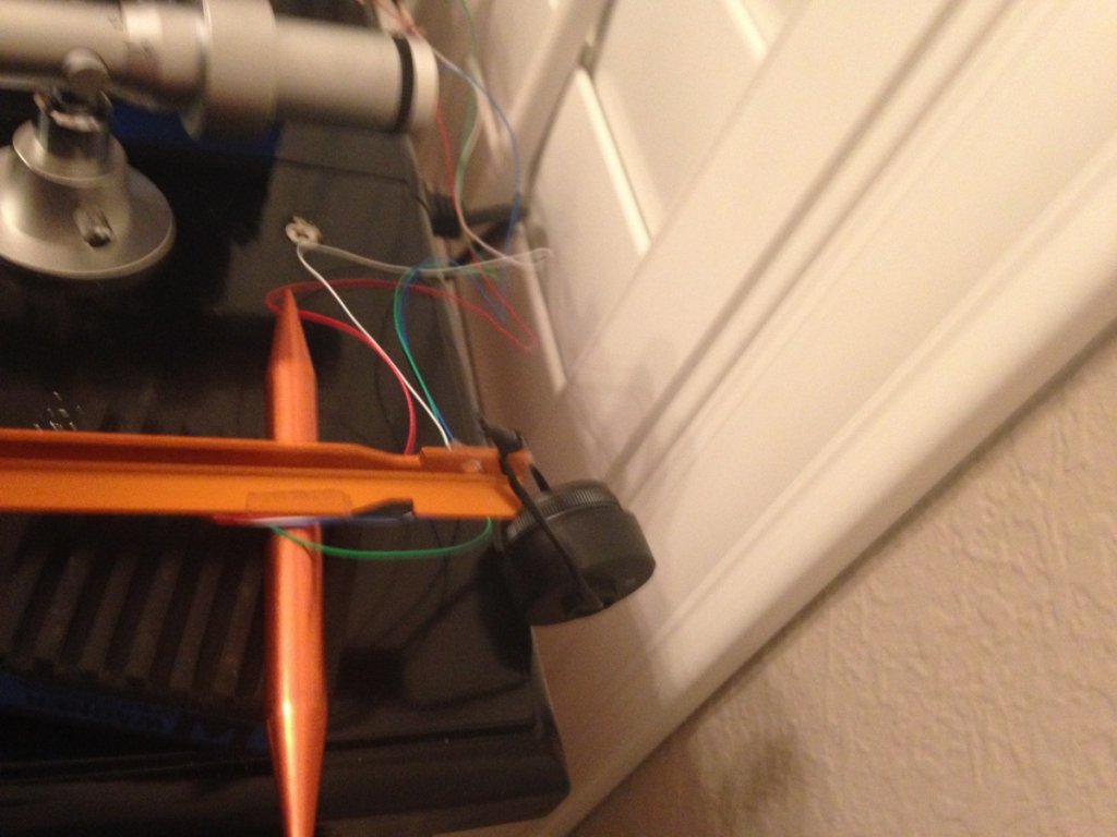

Inspired by the Well Tempered turntables with the arrow shaft for tonearm and golf ball for pivot I decided I
could do something myself but instead a radial tracker.  That would allow me to not have to worry about
geometry as much.  So here are my thoughts.
An aluminum tent stake for the tonearm.  $1.00 It is a triangular shape.  Like the Mercedes Benz emblem.  I super
glued an Ortofon Blue the end of it trying to keep it a perpendicular as possible.  I purchased set of tonearm
wires with cartridge pins for $22.00.  I know it can be done cheaper.  I took crochet needles to lay the track for
the arm.  I cut the end of some extra cheap interconnect cables to attach to the tonearm cables.  The good end
would plug into the preamp.  As a read super glue is nothing more than plastic I used it make the solid connection
after twisting the wires.  I couldn't get the tonearm attached using super glue to the arm support so I used some
U-glue tabs to make a temporary connection.  I U-glued the interconnect cable to the base so it wouldn't put
the tonearm cable wires off or cause a strain on the movement of the arm.  I put a thin layer of oil on the rail
to try to help the tonearm slide across.  The counter weight was left over from a Project arm I removed from a
previous Debut III turntable.
So how did it do?  Well the arm wouldn't move across but it did have a little play because the U-glue tab didn't
hold it solid.  When I moved it to the correct position by hand it sounded fantastic for a number of revolutions.
The VTA wasn't obviously correct either, but I'm still working on that part.    I believe the best part is the
aluminum tent stake for the arm.  It would be better if it was longer, but works as is.  I need a better way to move
the arm across.  I was thinking of a lateral counter weight but I'm not sure that would work.  I need a better
tonearm support too.  Thinking of using some epoxy as it would give it time to fix it at the right angle and be
solid.
