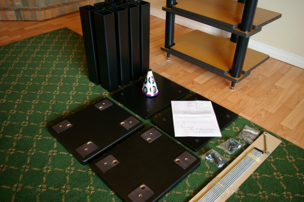

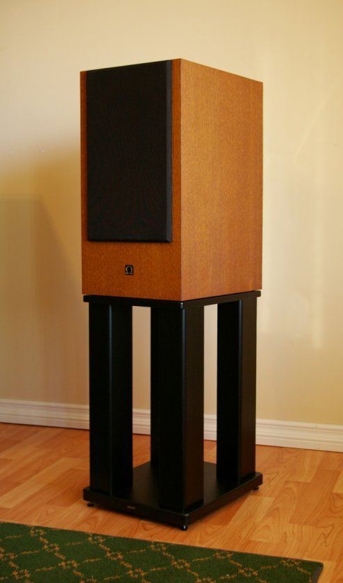

I promised Noel at Skylan I would do a mini review on the SKY-4P20 20" 4 post speaker stands he sent me for my Super Alnico Monitors.
Some years back Omega on Skylan stands were often seen at trade shows and looked and sounded just fabulous together.  Many an Omega customer put their speakers on Skylans back then.  What happened?  Why are they not seen together so much any more?  Answer: nothing happened really, they just drifted apart.  They are still as visually and sonically well matched as before, and they are coming together again.  I am by no means saying Skylan is the only suitable stand for Omegas, but they certainly are a great match.  Noel makes stands to fit all the Omega monitors now.
My history with Noel at Skylan goes back as far as when I started Audio Boutique.  I was too cheap to buy a pair of his two post stands, so I built my own Skylan copy which serves me well to this day, and every speaker I put on them does very well.

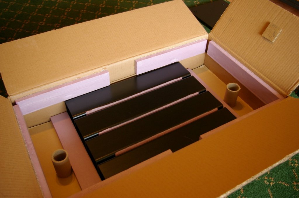

When I ordered my 4 posters, Noel said they would ship in 2 weeks and true to his word, thats when they shipped, ditto all subsequent orders.

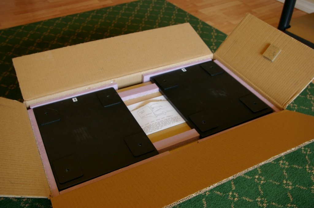

They arrived in a reasonably compact box that weighed around 30 pounds, and when I opened it the engineering of the packaging showed a lot of thought and care.  Examining the contents showed a beautifully designed and made speaker stand.  They are so well thought out that they about fell together in less than half an hour - everything fitting beautifully.  Fit and finish are second to none and a lot nicer than my home made copies.  During assembly I took a different route than what Noel recommended and did not fill them with rice, but instead put rubber dampers on the tie rods.  I want to be able to take the stands apart without a mess.

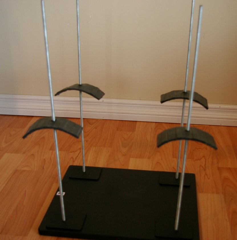

Addendum: I should have mentioned using rubber dampers instead of ballast has also yielded excellent results sonically.
Instead of being mass loaded, the stands are now lossy.  YMMV

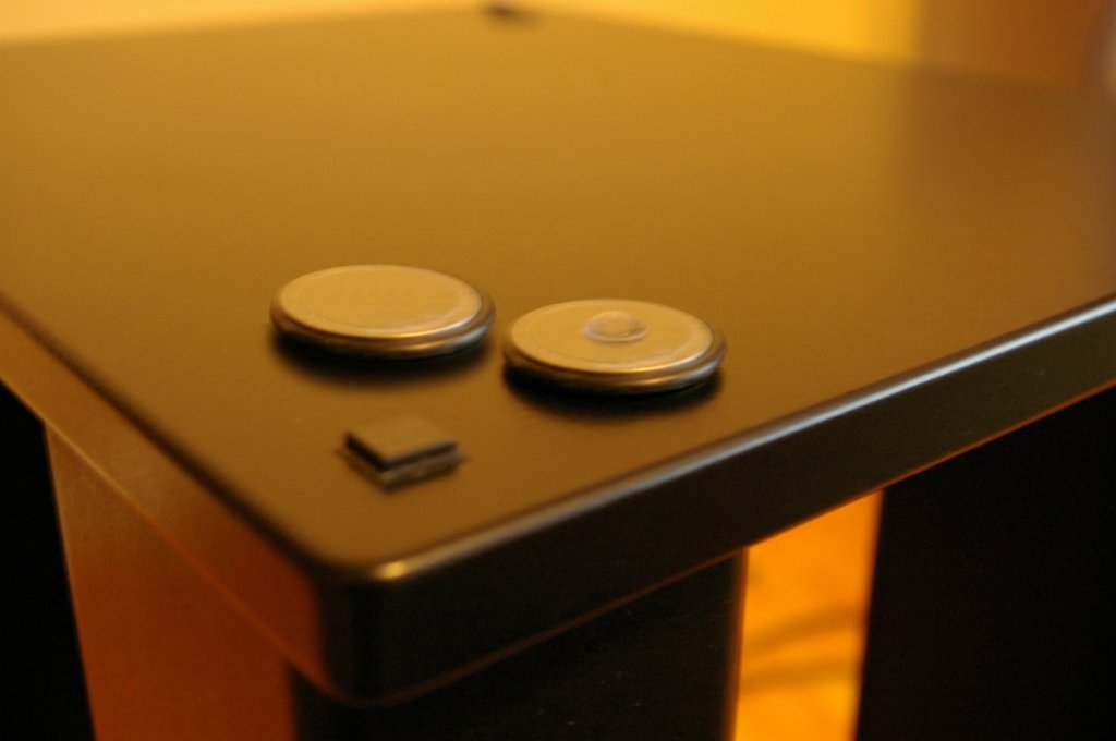

Noel sent along with the stands his Q-Bricks which are these little metal/rubber/plastic discs that look like flying saucers from some early 60s sci fi B film.  They plug into the tie rod T-nut on the top plate of the speaker stand.  The speaker then rests on the Q-Bricks literally tying the speaker through the tie rods to the floor.  Years ago Royd Audio did a similar thing to wonderful effect.  Today I played through a variety of music (mostly more complex) with the Q-Bricks in place and everything had such an effortless sound.  Nothing even broke a sweat.  The soundstage was huge with the recording venue faithfully reproduced.  One word has summed up this rig from the get go: reality.
I then removed the Q-Bricks and noticed subtile differences, I mean subtile, but still noticeable.  Marginally less refinement is the best way to describe the difference.  Would I have been in bliss if I had never heard the Q-Bricks?  Absolutely!  Now that I have them though, I won't part with them.  Skylan stands are often paired with Harbeth speakers which are lightweight and thin walled compared to the heavy Super Alnico Monitor and I feel the Q-Bricks may have an even more profound effect on the Harbeths.

Truckbed rubber rod dampers and top plate.

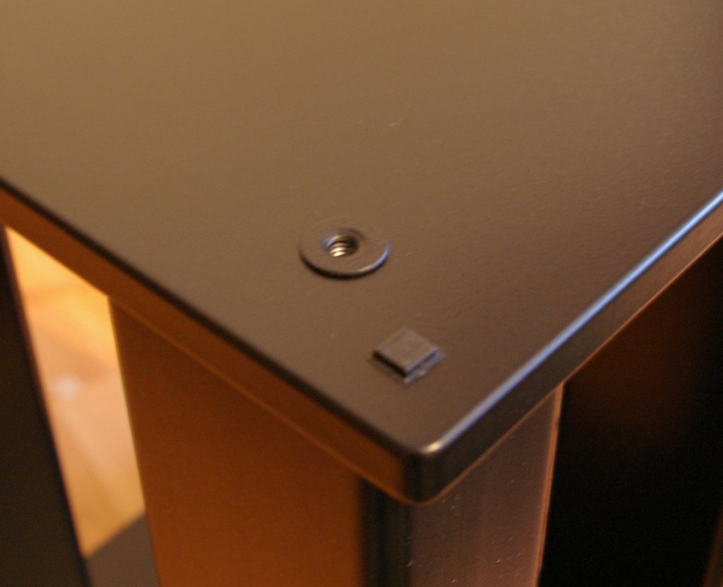

Stock Sorbothane square pad and tie rod T-nut.
Q-Brick on right upside down with neoprene locating dimple.  Q-Brick on left is flipped and plugged into tie rod T-nut.
The speakers no longer rest on the Sorbothane pads, but on the Q-Bricks.

Hi Rob, nice review, well thought out and detailed.  Just one question ~ what was your theory about not filling them?  Was it just because of the mess or did you have other thoughts about it?
Canada Rob
  • Posts: 1075
Re: SKYLAN STANDS WITH OMEGA ALNICO MONITORS
« Reply #2 on: 13 May 2015, 10:39 pm »
Thanks Beowulf,
I should have mentioned it was more than the mess.  My oversight.  The computer table which I designed and built uses the same treatment in the legs and I've had more desktop systems (some in the thousands of dollars) on it than I can remember and the sound quality is really good.  Speaker stand design seems to follow two ways of thinking: mass loaded or lossy.  Mass loaded would be a Target 4 poster loaded with sand, and lossy would be the Something Solid stands.  Not mass loading my Skylans would lean toward the lossy side.  Some of the best monitors I've heard have been on lossy stands.  Empty, the Skylans only weigh about 15 pound each and the sound I'm getting is the best I recall in my audio life.  At about 30 pounds each, I feel the Super Alnico Monitors don't need extra mass, just a really solid stand, which the Skylans are.  My 2 post Skylan copies are filled with cat litter for some mass as the speakers put on them are a lot lighter than the Super Alnico Monitors.  YMMV.
