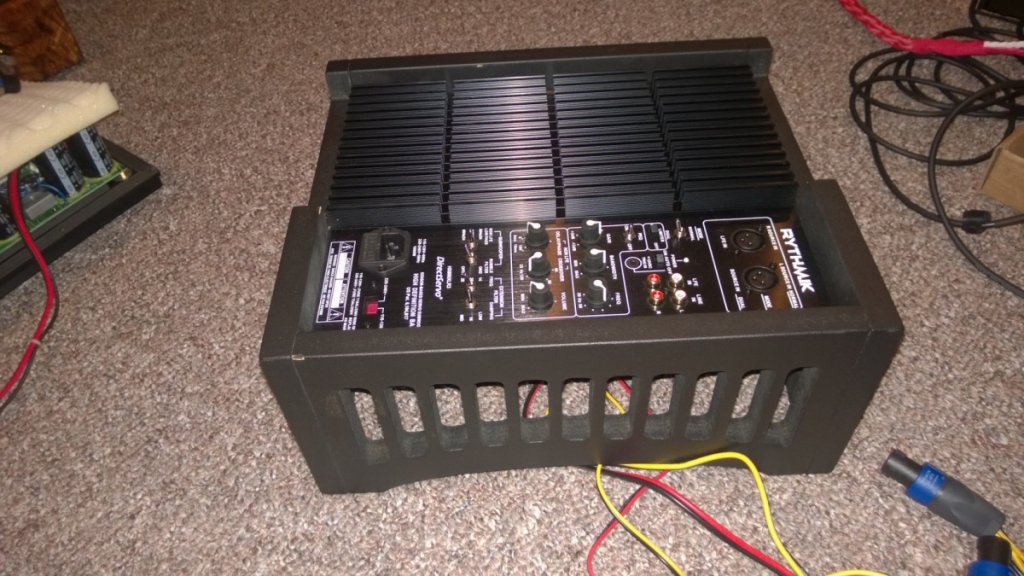

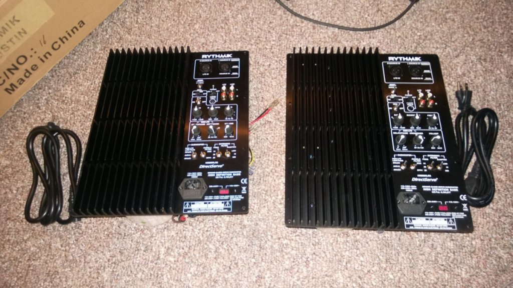

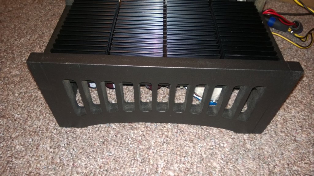

The two Rythmik Audio HX800XLR3 amps arrived today.
Letting them warm up after the cold soak of the travel and will start wiring them tomorrow.  Going to put them in the boxes from the A370PEQ's from the Super-V's for the servo woofer columns.  Have an idea of how to minimize the wiring length to try.

Just got them in the wood frame boxes from the A370PEQ amps.  Wiring tomorrow!

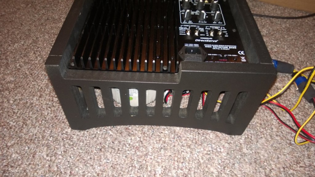

Those are interesting boxes. Any chance of a couple more pics and details?

« Reply #184 on: 20 Jan 2016, 01:53 pm »
They were built for Danny IIRC in 2009 for the pair of Super-V's I have.  The Rythmik Audio A370PEQ and HX800XLR3 are the same dimension plate amp faces for the opening to mount.  The HX800 is deeper, but the case was deeper to start with.
Will take a few more pictures and post, but I have no measurements for them.

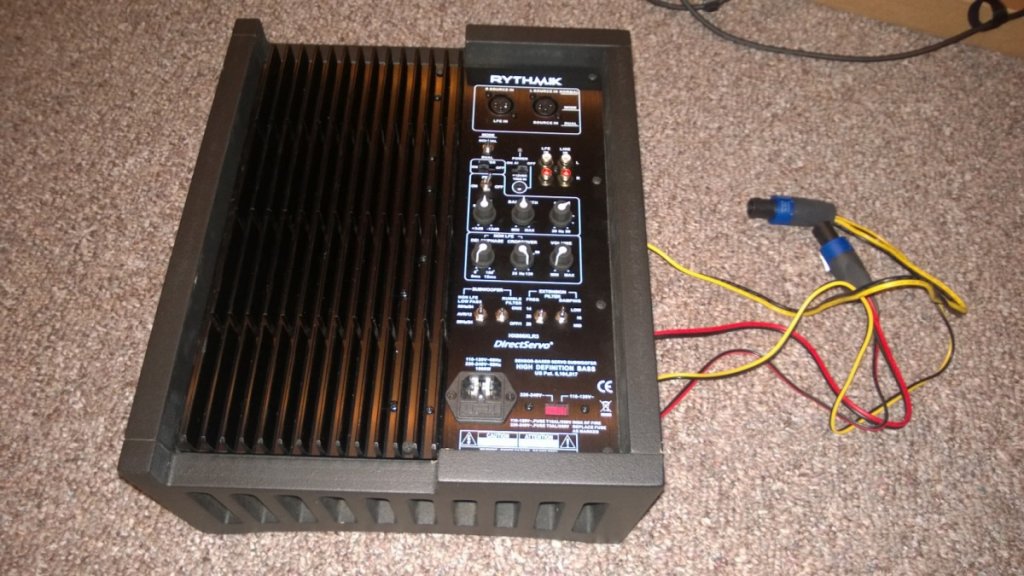

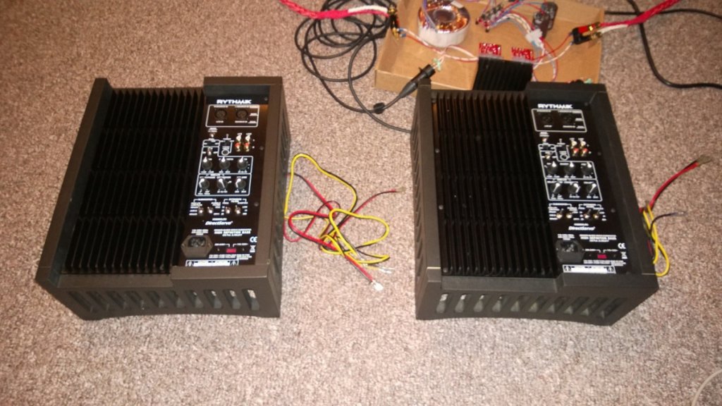

More servo amp box pics:

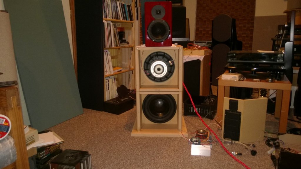

The HX800XLR3 servo amps are wired and running.
Since I am testing balanced input amp designs, decided to put the X-LS speakers on top of the 2x12" for listening trials.  The amps need turn-on relays to protect the planar drivers.  There are turn-on and turn-off thumps connected without the protection circuit.
They sound really good this way!
