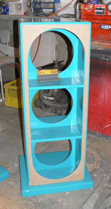

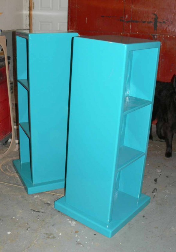

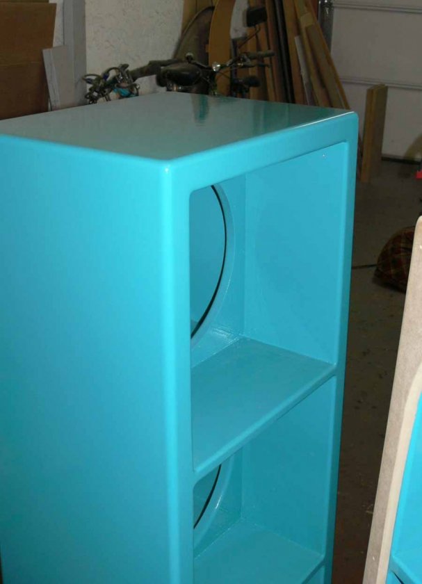

The cabinets are back frm paint and there is good news and   bad news.  I guess the good news first...  the water baed automotve paint   worked extremely well.  It has a great finish and seems to have adhered very well.   The color is actually   a  Turquoise, Don still hasn't decided on  grill cloth,  we've looked at  white,  black and grey, possibly even  looking for a  pattern  or something  with some accents of some kind.
The bad news...   I was worried about sending the cabinets in without  priming them first.  We spoke with the painter and told him,  if there  were any  issues that come  to  light after primeing call and we'll   take  care of them.   Well, there were a few  issues and  no, they didn't call, they just painted right over them :(
 Aside from the seams not being  100% perfect,   it would appear they didn't do a very good job of wiping the cabinets downwith a tack rag  before spraying.   In cetain areas , there are very small bits of debris  in  some places, pretty frustrating.  In a couple of spots , it almost would appear they  bumped the wet paint with  something.  If hey had spent  a bit more time , or called us after priming, the  paint could have been much better. given that,  the paint still looks very god,   just  there are  some areas  which obviously needed some more atentin
Rich, I'd say as long as yu  use a poainter who'll pay a little more attention to detail, you  have absolutely nothing  to worry about using the  water based  automotive paint. Like i said above, the finish is actually   gorgeous,  the issues are with the  care taken    with final prep and  possibly  right after  the  paint  was appliied..
I'm going to try a bit of 1500 grit  wet paper to try  and  deal with a couple spots  (startng otn he rear of the cabinets to sample) and see if  I can't improve a couple areas before installing the drivers, no res, and wireing  them up.

You're 100% right on all points Mike.  The part that gets me  is that aside from a bit of seam showing in  spots,   they  were just  careless and apparently lazy.

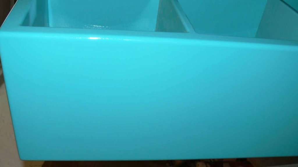

Rich,   as stated above,  they look pretty dam good  for the most part, the paint has a beautiful finish to it, not even comparable to a rolled  finish. It's bascially  an automotive finish and it would appear to be quite durable, at least that is the impression I get.
Just be careful when you pick your painter and explain to him  what you expect, don't take it for granted  that he'll know.

here is a better pic of the actual finish  for you Rich,  guess the actual color is  somewhere between  this and the ones taken with the flash above, very light dependent

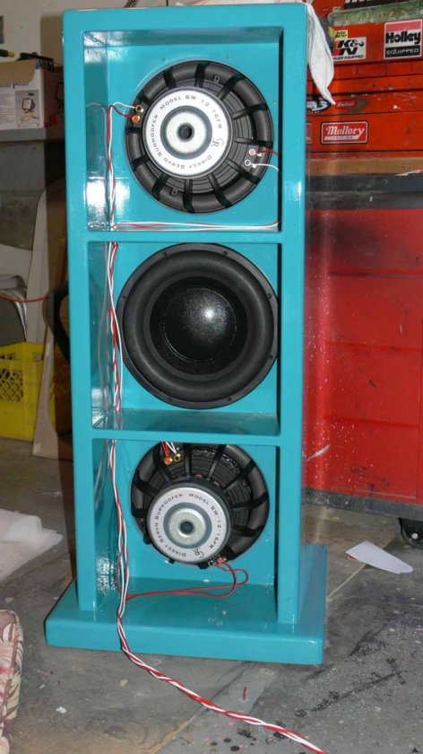

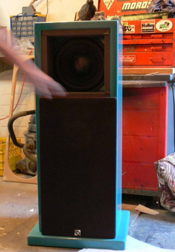

One done  ,  up and running and sounds  GREAT !   Don is  doing his happy dance    :dance:
Drivers installed & wired
No rez
Apic for the wife to see if  black is the color  for  grill cloth
We pulled one of my dual s out and  placed this in it's place.  man,  I thoght the duals were heavey, OMG.
It's only the 1st and it's only been playing for about an hour but  oh boy,  can't wait  to get the next one hooked up.....  I can see me ordering  2 more drivers  and building some new cabinets in the not too  distant futre
Danny,  you'll be getting a call from Don first thing,  we ran out of wire  :(
jay

 Why No-Rez in front of drivers?
Re: Triple 12" OB H-frames
« Reply #97 on: 13 Jun 2015, 04:08 pm »
Jay,
hey Larry
All of the 6   driver cavities (3 front / 3rear) get lined with no res from baffle to basically the front edge to help reduce any cabint resonance.   Those sections are basically 6.5" x 13"  panels surrounding each driver.  Just trim about 1.25" of the foam from the baffle edge of the no rez to give the driver some clearence  .  On the  12's,  one sheet per driver works out  perfect.

Just to make sure I understand correctly 1 sheet of NoRez per driver x 6 drivers = 6 sheets of NoRez for the two 3x12 cabinets, correct?
Mike
« Reply #99 on: 13 Jun 2015, 04:38 pm »
Mike
Yup, you'll have about an  inch left off each 13" strip  and each 11" strip  ( I cut each  sheet into a 13 x 27 and 11 x  27 piece then cut  tose to  6.375 pieces , 8 in total for each driver)
