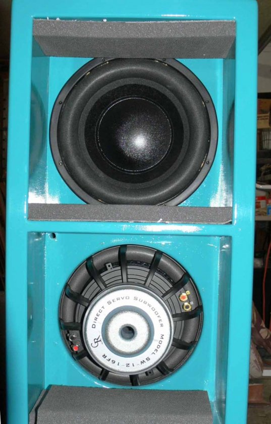

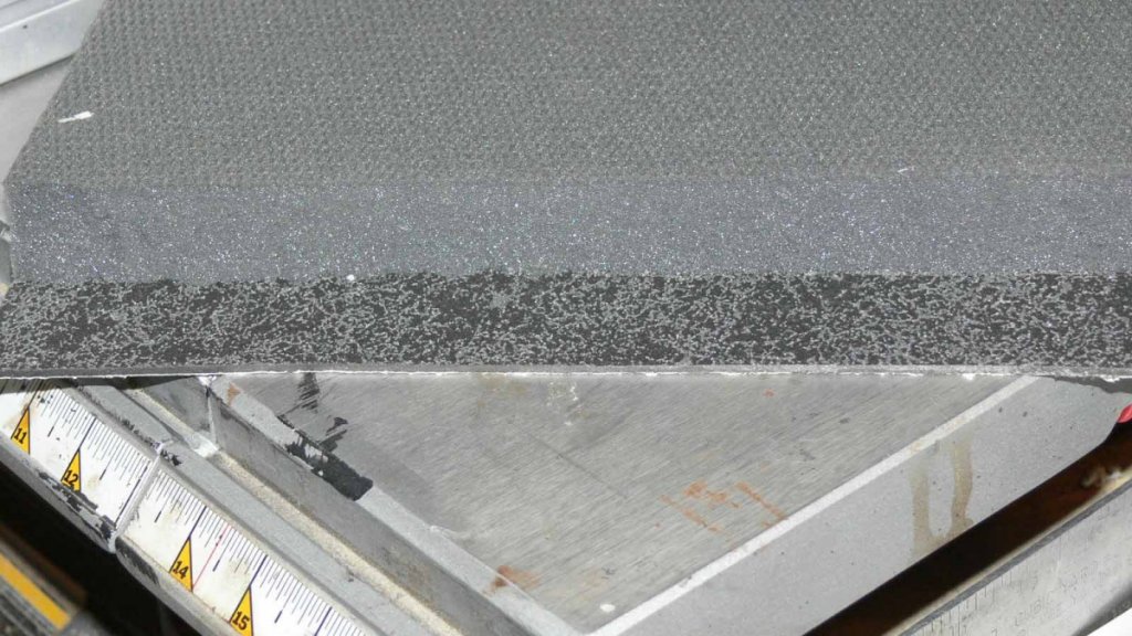

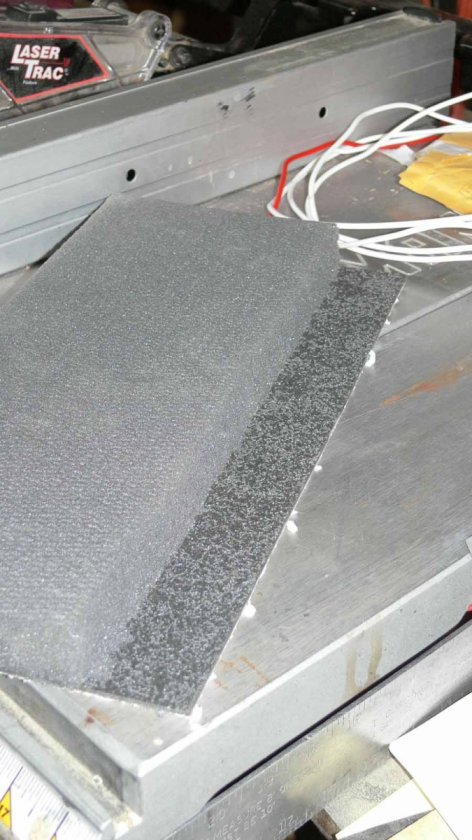

Here you....
After cuttingit all, just a matter of  peel and stick  :thumb:
Here's the trimmed edge, do this to every piece on the edge that goes up against the driver
Then it's  just a matter of peeling off the  backing...

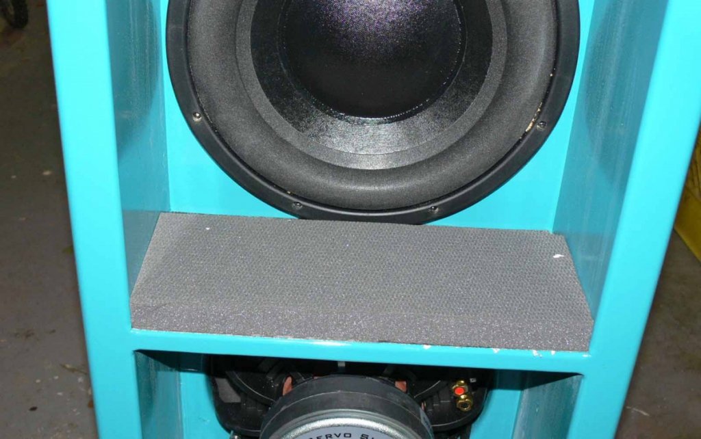

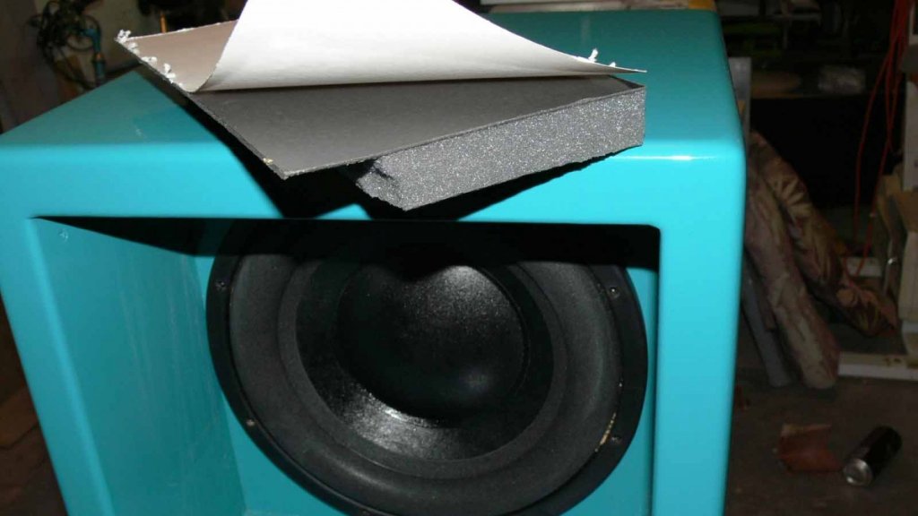

Do the bottom piece
ZThen the top piece....
Finally slip in the  2 11" pices on the sides
Repeat for the other  44 pieces of no-rez.... or in Rich's case, the other 92  !!   :lol:
Remember, apply to a clean surface and try and  rub down each piece as you apply it with  preasure as best you can.  The no-rez actually adheres very well.

I find that my jigsaw does a superb job of cutting the no rez.  Scares me less than table saw and cuts all the way through the foam.

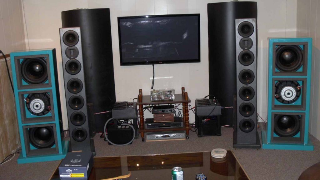

well.....   as  one might expect,the duals and the triples sound  siilar in the fact they both produce extremely  clean,  tight, and accurate bass. Both are  very fsst and integrate seemlessly with my OB7's. . These  subs are so adjustable with the  features of the  A370PEQ I can't see an issue integrating them with  anything. I've paired a   set of  x ls encores with my duals and they sound great.
the triples offer  more...  you are moving a 3rd more air so there is more punch/weight behind everything, you definately feel  everything   more and  amazingly enough, it seems even  tighter and more defined playing  at the same SPL, there seems to be more  "ambiance" in the room too.
Along with  moving 1/3 more air volume, you are  working  the drivers less to reach  the  desired SPL so  things are cleaner, the drivers are not working as hard .  you'll probably   notice this more   the louder you play the subs  being  the duals will have to work that much harder to keep up
I won't be  upset in any way switching back to my duals, they are wonderful and  the triples are BIG ....  well I gues that is relavent right Rich (Mr dual 6x12's :thumb:)  I am glad i built my duals using the 16 ohm  version of the 12" servo woofers, it leavs me an upgrade path if I ever want to  build the triples... build new cabines and buy 2 new drivers.
I wouldn't say  that going  tothe triples would be overkill for anyone, even in my  18' x 12' room they sound great, the OB servo subs just don't seem to overload the room.  I am really anxious to hear them up at my buddy's place  where they will be in much larger room

Yup, and I had to put the triples in my room for a couple days  :duh: .... I took them out today and went back to the  duals... a little more  noticeble than I had originally thought.  As I noted above,  the accuracy, definition and musicality are very smilar, basically the same, between them, but the  "weight"   produced by the triples is more apparent than i thought.
007KLH,  with everything i listed above, you're closer to $2300 I believe + cost of  cabinet material/finishing etc
You'll be happy  though  :beer:

   Good job Jay. The triple 12" OB H-frames look great !   :thumb:  I'm sure they must sound awesome.
mresseguie
  • Posts: 4958
Re: Triple 12" OB H-frames
« Reply #138 on: 10 Sep 2015, 04:30 pm »
Hi, Jay.
Those look amazing - I imagine they sound amazing as well. They really dominate your room (or, perhaps, it's because of the different color?). You clearly are highly skilled!
« Reply #139 on: 11 Sep 2015, 02:29 am »
Hi, Jay.
Thanks  Michael, Ron.
It's not  just the color, although I'm sure that plays a part of it !  They do dominate the room  but, they don't over power the room.  They are impressive to listen to.
We moved them to their new home yesterday afternoon. Will be going up on the weekend to do some final setup  , I'll try to remember to grab my camera and post a shot or two. Eventually they  will  have the grill frames wrapped in white cloth
