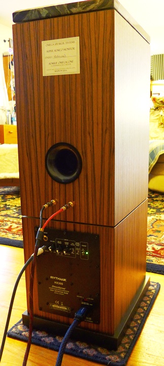

Couple of things
1) those are rythmik bass units and not LC/Omega's own design?  interesting....
2) the veneer is outstanding and the matching between the top and bottom is flawless.....wow
3) HOW MUCH....
pstrisik
  • Posts: 1378
  • Holding pattern in Audio Nirvana in the PNW!
Re: Peter's Super Alnico Monitors with matching powered woofers
« Reply #43 on: 29 Jan 2016, 08:36 pm »
Couple of things
3) HOW MUCH....
1) Correct, rythmik bass drivers and plate amps.  Not ordinary subs as described earlier.  The amp is modified.  It is limited to 30hz low extension but has a setting for 50hz 24db/octave HPF.  They will handle 50hz to somewhere between 100 and 200 hz depending on setting on the Marchand active crossover.
2) Thanks I agree!  They actually look better in person.  The lense distorts the straight edges and highlights the gap between the cabinets which is really much less visible.
3) Let me check with Louis about posting prices.  We are actually still working that out.  It is atypical since I supplied the Rythmik drivers and amps.  He built the cabinets for them along with the monitors.  The 8" Rythmik driver is quite compatible on paper (still have to get them running to listen).  Light paper cones, foam surrounds and his proprietary servo system, all of which together make for very fast speakers.  I have a pair of his F12, 12" subs with plastic cones and rubber surrounds but the servo technology makes for fast, detailed, musical subs so I expect excellent results with the smaller, lighter drivers with massive magnets.

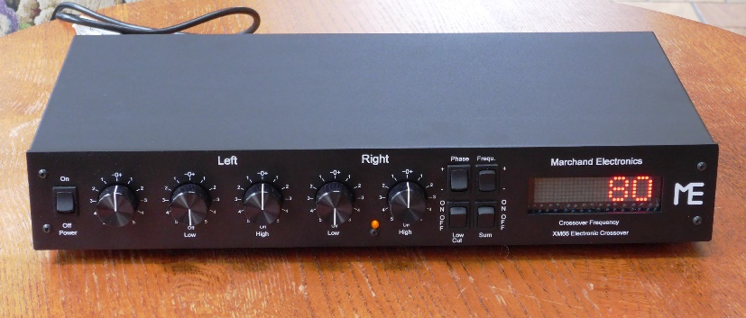

Another configuration with these is to run the woofers down to 30Hz (switch to set for either 30 or 50Hz low end).  In this configuration, I could easily run without subs or run subs at below 30.  If I had to downsize (like an apartment or senior housing someday  :o), running them this way without subs would be the way to go.
Here's a shot from the back..........
And the Marchand XM-66 line level crossover........
