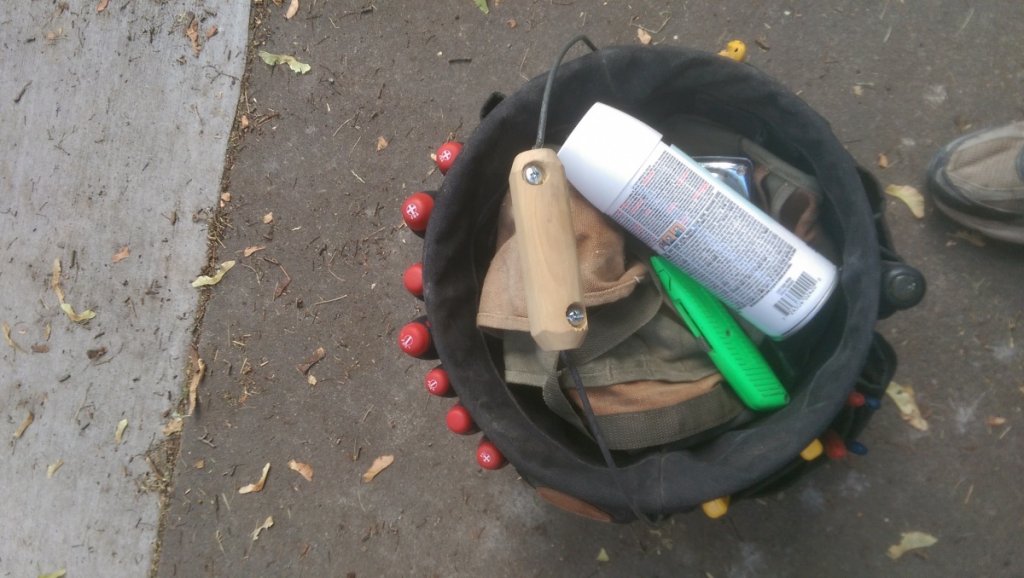

Can't use the tools if carrying it around busts your hands... Poplar, nice and fat unlike stupid snap on things you can buy. (it's wider than it's depth you can see)

There are really nice bags these days that work great and don't have hard small handles. I don't like 5 gallon buckets for tools, the bags work much better and are designed for different uses.

Ya but they're not free!
