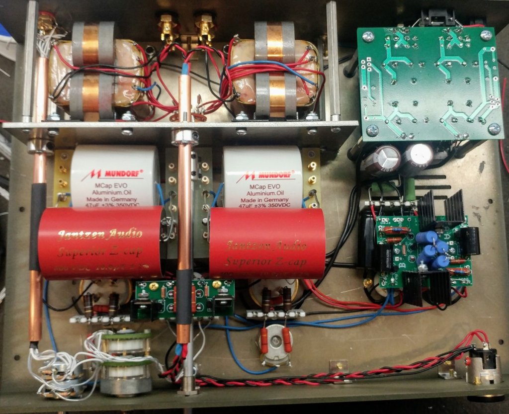

6C6 directly coupled to 2A3 running at fave operating point for about 2.5W out. A build experiment that got a little crazy a couple of years ago; heavy for a directly coupled amp at about 25kg per mono. I learned a bit and am currently purchasing parts for my next amp... which might be crazier.
Needs a clean
Some interior. 0v signal ground is different now (-ve of reservoir cap to spot near safety earth).

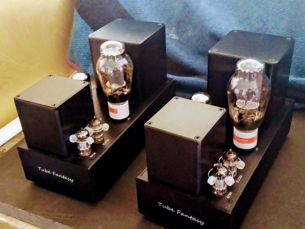

Here's my brand new 300B SET. Sorry for the mediocre photos. Too much light in the room for a low dynamic range smartphone camera.
Hand laid transformers. 300B, EF86, GZ34, 12AU7 tubes.

This thread is about sharing about our amps - I didn't really do that.  :oops: I find that difficult because of the many details that went into this amp: it really was a bit of a thought experiment and I would not recommend an amp build like this... though it does sound lovely (slightly warm, coherent, expressive with surprisingly linear-sounding bass) despite (because of?) the high frequency roll-off expected when a low gm pentode drives a DHT.
The basic design is a classic direct-couple, not Loftin-White or monkey or variants. I like the sound of the EML and JJ 2A3 tubes with the plate at roughly 1mA:6V, in this case 42mA and 250V with a 4.2K load; AC filaments. Good for maybe 2.5W, probably a bit less. Tubes will last forever if start-up and filament voltages are well-managed. The 6C6 is run as pentode at common operating points. The only bit of trickery being that a voltage divider is used to derive screen V (rather than a simple dropper) and the screen bypass is returned to the cathode, rather than ground. PS is a simple tube-rectified pi filter designed for low impedance and fast and clean recovery - I will do it differently next time...
Build was guided by a few things I wanted to achieve and just experiment with. I wanted to be able to compare this build to a RC coupled amp of similar design that I own; ensure reliability and low noise/hum/buzz; use quality transformers and chokes; avoid 'lytic capacitors; minimise parasitic capacitance; avoid magnetic and dissimilar conductors where practicably possible; keep current loops direct (if not as short as possible) and treat them with the same care as "signal"... blah blah blah.
I don't recommend my design choices or expect others to have the same goals or make the same choices. I like that humans have diverse opinions and make different decisions.

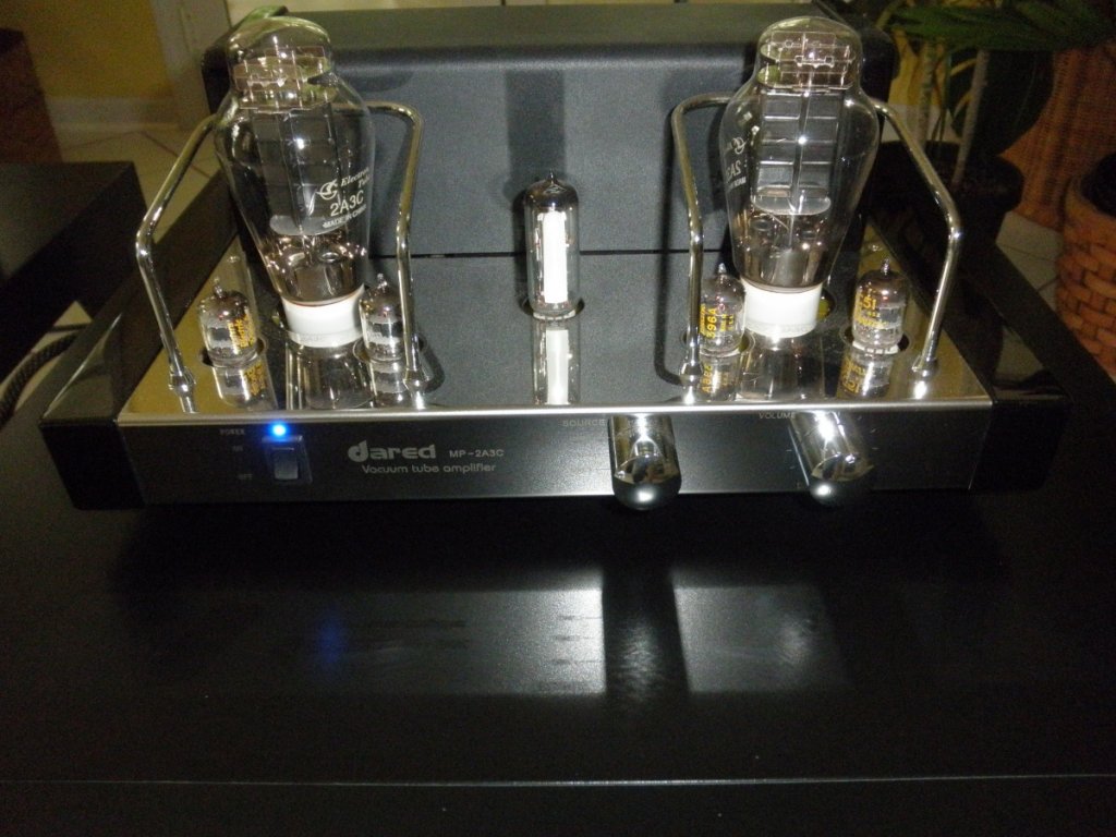

Dared 2a3

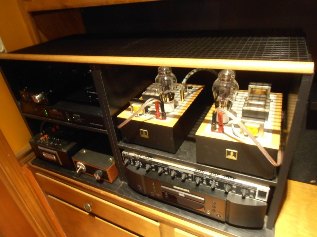

After being out of the hobby for quite awhile, I am enjoying seeing some of the amps that people have been playing with.... these are a couple that I have had in my systems...

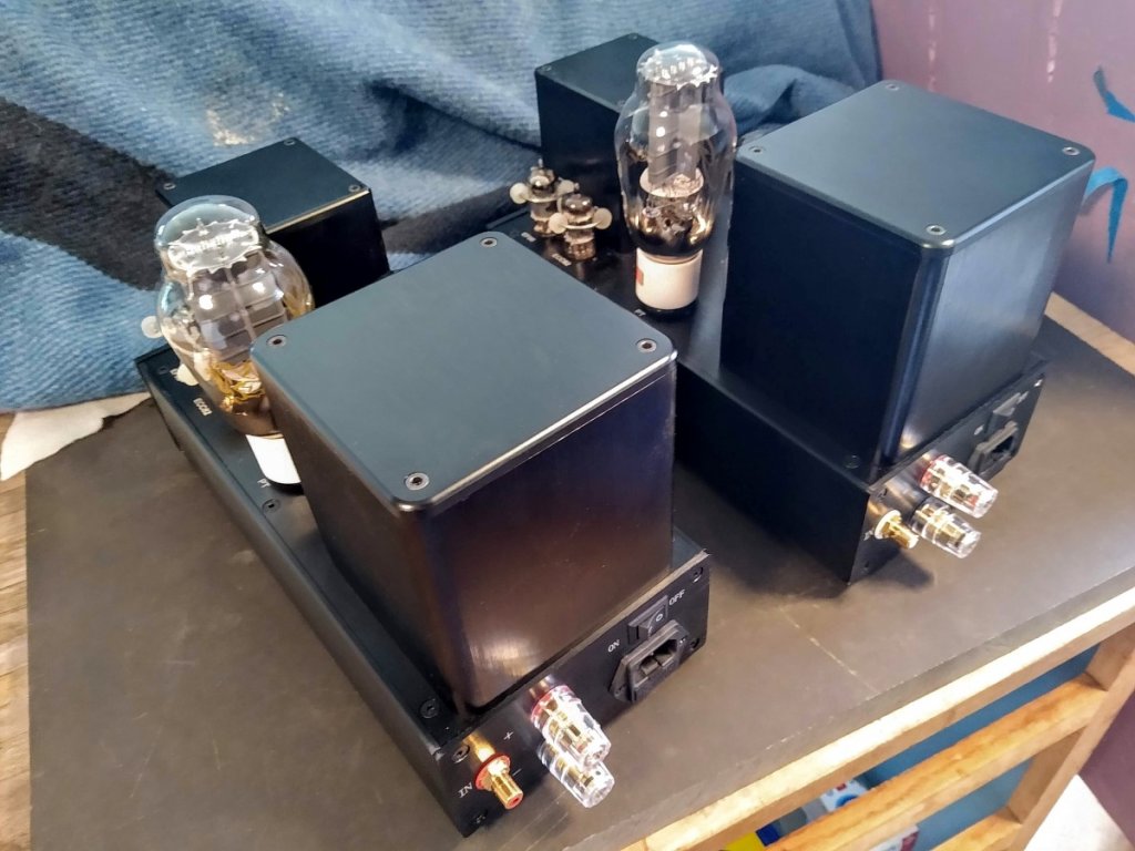

Audio Note Kits 300b SET Interstage Mono Blocks  8)

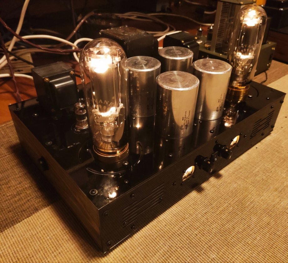

Don't think I've posted this one.  My new low powered 845 amp by Paul Birkeland.  Great amp!

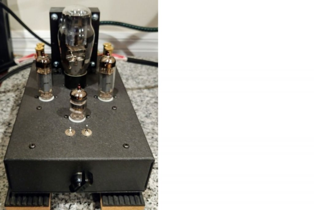

Decware SE84C+ updated to CKC uses 6p15p output tubes.

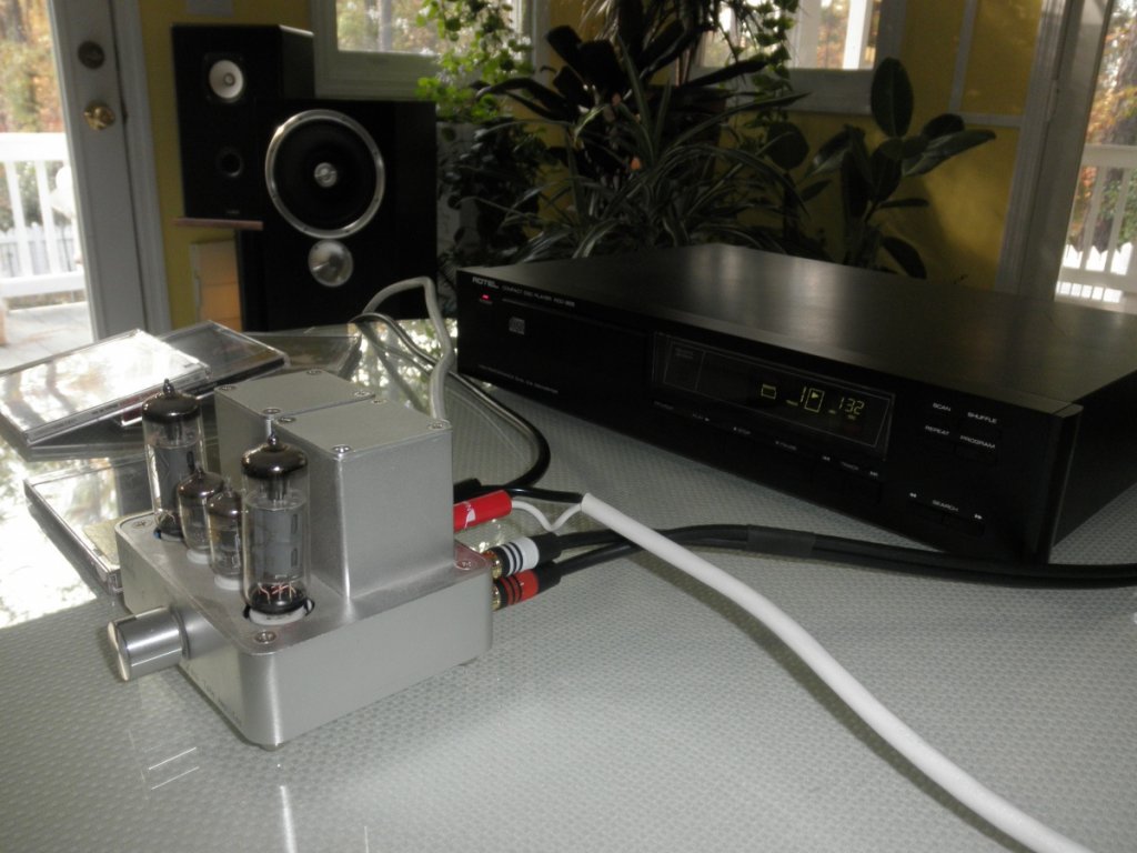

I use a Decware Zen Triode with a pair of vintage Klipschorns. Great vocal and soundstage.
