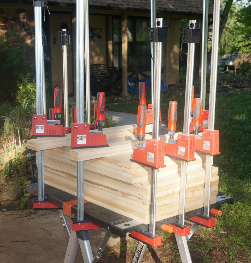

I'm using 3/4" MDF for this build. Since the tops, bottoms and sides need to be double thickness, the first set is rough cutting the parts oversize then laminating two pieces together.  Here the four sides and two bottoms have been laminated together, stacked on top of each other then clamped down.

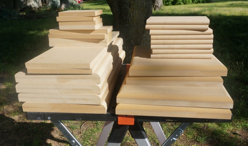

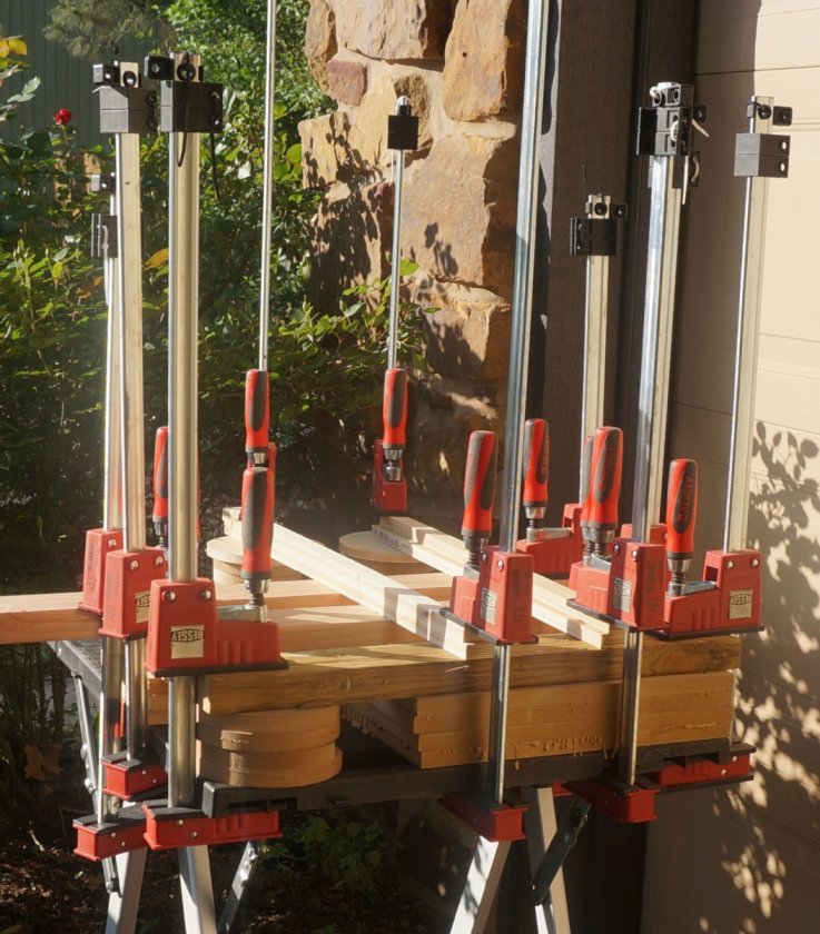

Since the tops were so much smaller I clamped them up separately.
The baffles have been roughed out.

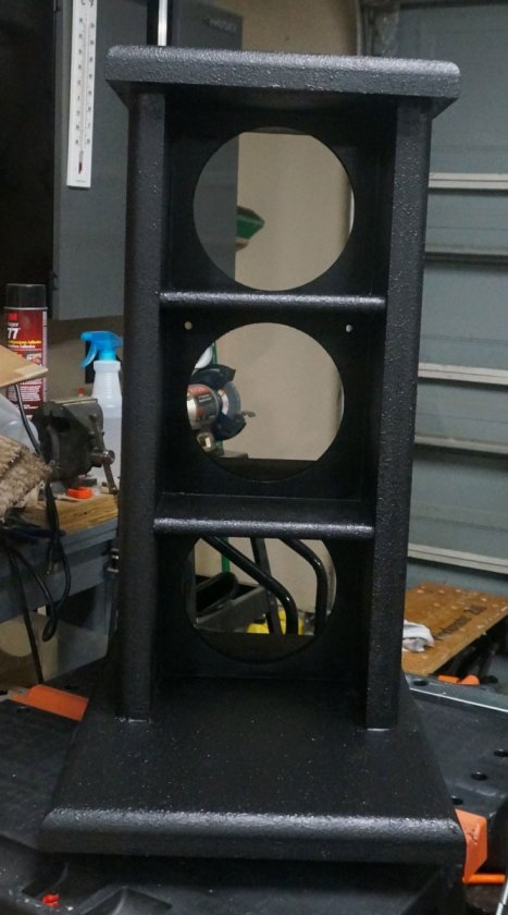

Just glued up one of the amp boxes. I made the bases extra long offset to the rear so I can mount the amps to the stands.

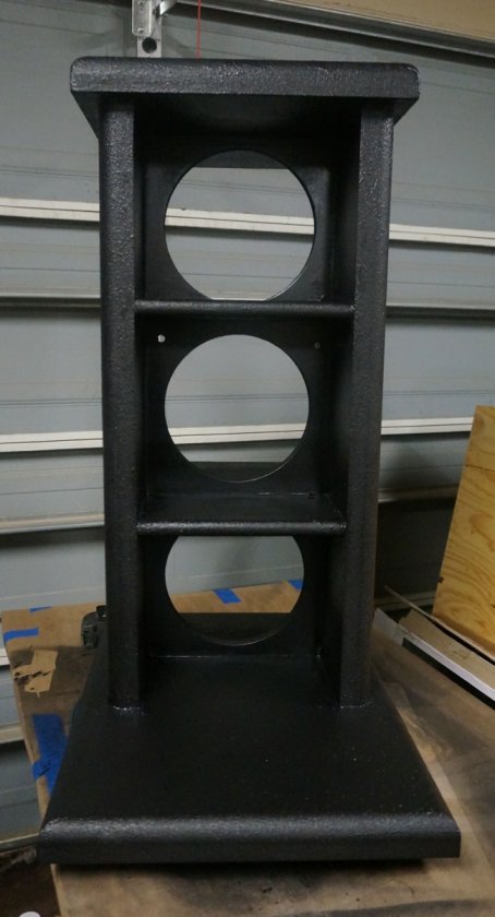

I have not venerred the H-Frames. Due to time constraints for LASF I used DuraTex on them. Here are some pics. You're looking at the back sides. The extended base is where the amps will sit.

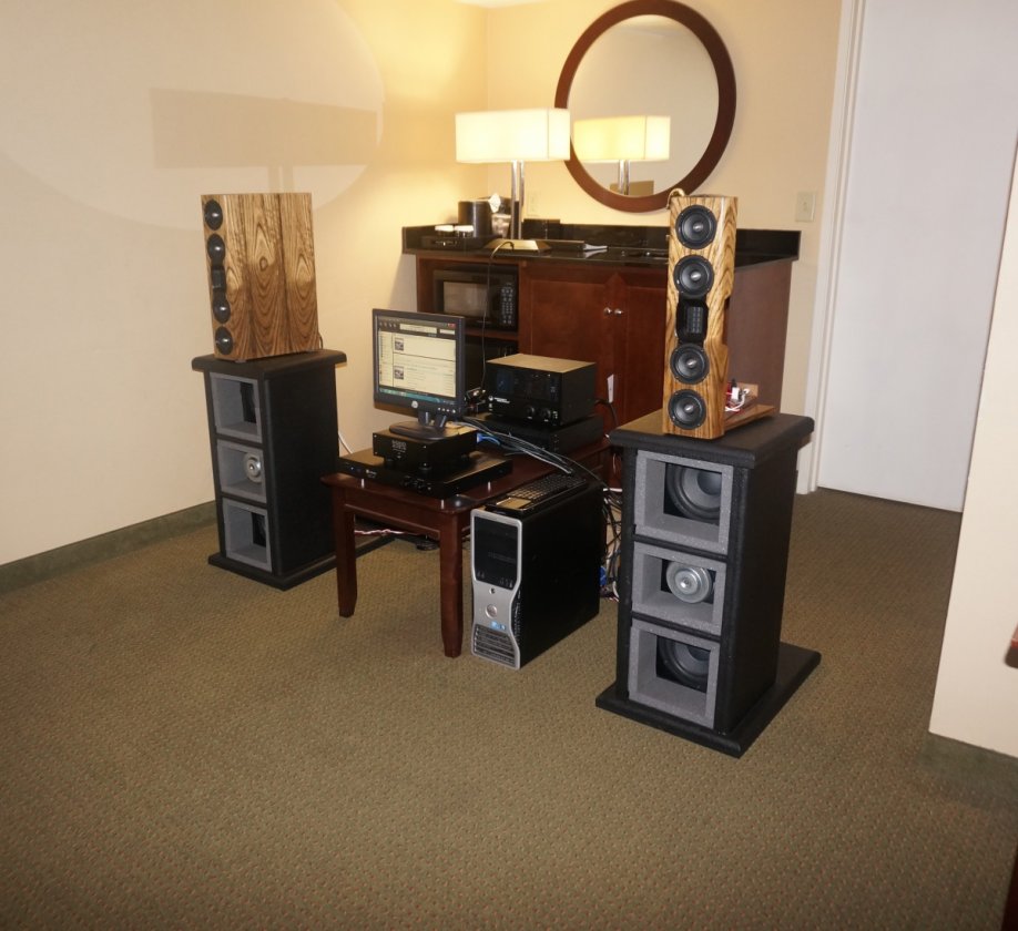

Here they are set up and playing at the festival

Pics really show just how small the Wedgies are !!
Bet you are loving them   :thumb:
