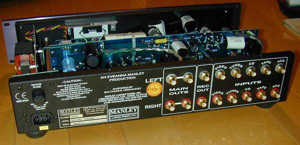

Escott1377
  • Posts: 560
Re: DSP Device
« Reply #6 on: 16 Apr 2015, 09:28 pm »
 My pre amp has dual outputs for bi amping.

JRace
  • Posts: 610
  • Greetings one and Everyone!
Re: DSP Device
« Reply #8 on: 16 Apr 2015, 10:20 pm »
The dual outputs are just a single output split inside the preamp.
You can just use RCA Y splitters instead.
Run output from pre-amp into DSP.
Then using RCA Y adaptors on the DSP output you would then run that into your amps.
Escott1377
  • Posts: 560
Re: DSP Device
« Reply #9 on: 16 Apr 2015, 10:31 pm »
That seems easy enough.  Thank you.
