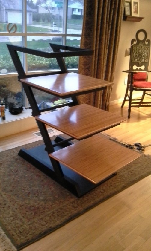

The arms are 1" x 1.5" thick solid 6061 aluminum. I'm guessing conservatively that they'll hold up just about any amp that'll fit on a 20" x 22" table.
I'm sure you're right.
I'm a fan of both Bamboo and aluminum as well as cantilevers, but not so much of angled racks.  Beyond the polarizing aesthetics, they take up more floor space.  I like to get close and personal when operating a turntable, and having to lean forward with my ankles or shins up against the bottom shelf would be too much of an ergonomic tradeoff even with improved heat dissipation.
Perhaps consider an upright variant as an alternate model?
Steve
EdRo
Re: What could this be???
« Reply #21 on: 10 Apr 2015, 06:29 pm »
Hey Steve. Thanks for your insight. I would like to point out that this rack is truly open on three sides. It wouldn't be tough to situate a turntable for easy access to the left or right on these floating shelves. And, these shelves are 20" x 24". I think I put down 18" x 24" earlier. Plenty of room for a turntable and various weights, say, or Star Wars action figures even. (My wife prefers Lady Death)
Again, thanks for the insight, guys. I want this rack to be the best that I can build.

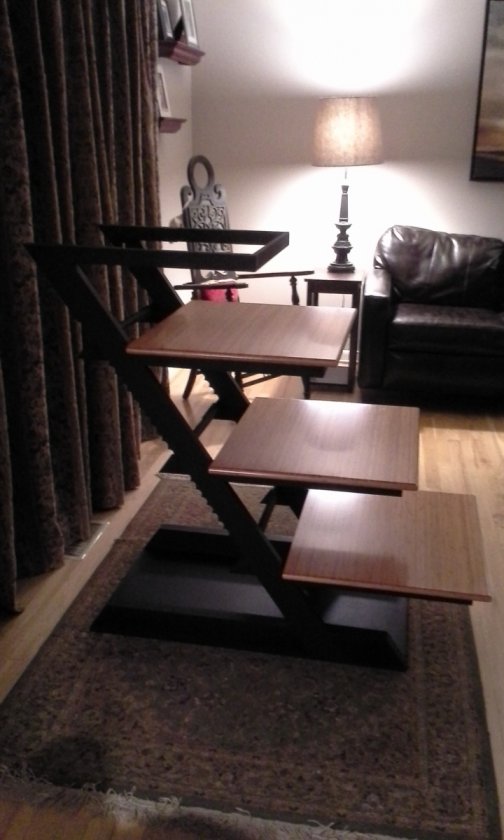

Yup. Thats exactly what I meant. Standing to the left or right of center will allow unfettered access to anything on the rack, whether it's on the bottom, mid or top shelves. 3 dimensional chess would be possible, since the shelves are floating and completely open on 3 sides. I apologize for the confusion; as soon as I get the parts from the anodizer I will take a plethora of pics. Since this is my prototype,  I hope to have lots of feedback. I really appreciate everyone's thoughts on this.
EdRo
« Reply #29 on: 20 Apr 2015, 02:00 am »
Here's s'more pics guys! Almost done!!! What do you think?
« Reply #30 on: 20 Apr 2015, 02:43 am »
That's pretty sexy.
I have no doubt I'll rip off that idea someday.  :wink:
EdRo
« Reply #31 on: 20 Apr 2015, 03:00 am »
My idea was to try to get the rack to disappear; I wanted the shelves with equipment to visually float.The shelves are completely open on 3 sides for full access and viewing. So many manufacturers out there have spent so much effort to make their gear look great. Why put it behind 4 massive corner posts, one shelf on top of the other? I say let those glowing tubes breathe!!! Let the craftsmen that put the effort (and the customers that PAID for that effort!) to make equipment not only sound great AND look great enjoy the fruits of their labor! Don't hide your expensive gear under boring stacks of shelves groaning under the weight of their own visual mediocrity!!! Be FREE of your chains people!!! BE FREEEE!!!!  :banana piano:
« Reply #38 on: 20 Apr 2015, 05:29 pm »
Thanks for the link, Sunnydaze! I guess there isn't anything new under the sun. I had the inspiration for my rack design from a climbing tree stand. I figured that this design would be ideal for high end audio equipment, because it could do many things very well. I designed my rack with larger shelves and a "double spine" spaced 20" apart for clear access to the back of most equipment. I wanted 3 sides completely clear; not just for viewing gear, but for ample clearance for maximum air flow around components. The rake back, while taking up a little more space, avoids the "tower of heat" norm without using noisy fans for cooling. I wanted tool-free shelf adjustability. When one of these shelves are lifted in the front, it can then be slid up or down easily. The "teeth" going down the back of the double "spines" keep the shelves where they are put. Not only do the shelves appear to be "floating" in the stand, but the bamboo shelves are also floating on the arms themselves; resting on Herbies finest db neutralizer pads. 2 pins (one on each arm per shelf)keeps each shelf in position if and when equipment might be slid in place. I didn't want the bamboo anchored down to the aluminum to help minimize transferred vibration from the aluminum structure. Not to mention the threaded stud gliders with more db-Neutralizer to keep things quiet from the bottom up. Thanks, Steve at Herbies!!! They really make great stuff over at Herbies!!!
