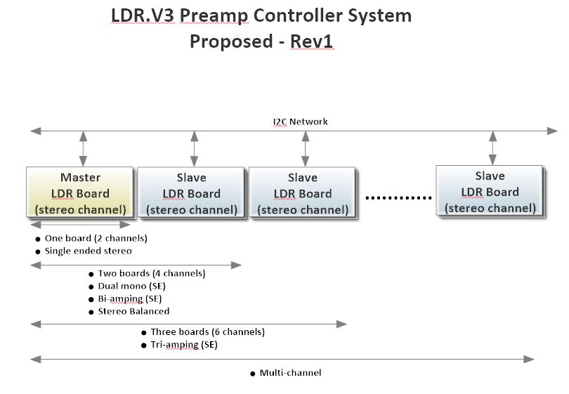

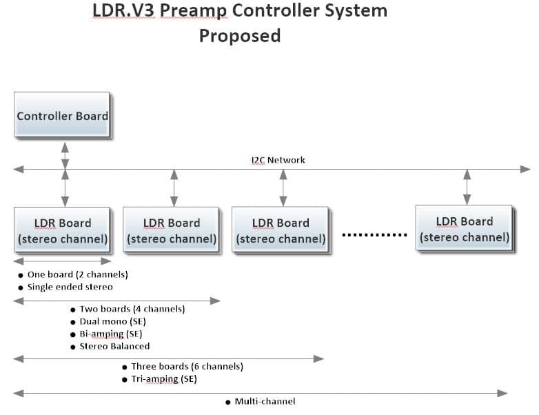

While still very much early stage, version 3 (V3) of our LDR preamp controller system is taking shape.
A key departure with earlier versions (V0, V1, V2 & V2.1) is the V3 will physically divide the preamp controller into 2 different board types; the Controller Board ("CB") and the LDR Board ("LDRB"). The CB will do most of the work and is the "smart" board that communicates with both the LDRB as well as the outside world (i.e. the user). The LDRB will contain the actual LDRs for one left/right single-ended stereo channel. The LDRB will simply respond to commands from the CB. The CB and the LDRB will communicate over a simple I2C network.
By breaking this preamp controller system into 2 board types it will be much easier and much less costly to implement multi-channel systems. For example a balanced audio preamp would require only 1 CB but 2 LDRBs. If you wanted to add additional stereo channels you would just add more LDRBs. This approach would definitely make bi or tri-amping more practical including multi-channel DAC attenuation.
As currently conceived, all power will come from the CB which would have separate digital and analog voltages which would be distributed to the LDRBs. Connections between the CB and one or more LDRBs would be via daisy chained 2x5 ribbon cable connectors so they could be physically arranged/distributed as desired.
Both board types will utilize mostly surface mount components which should make everything smaller yet there will still be various pin connectors to a host of external devices as before. At this point it appears we have eliminated the use of op amps entirely along with a good number of related resistors. Hopefully that won't change. Changing from 12 bit to more flexible 16 bit DAC/ADCs has helped simplify and further reduce total parts count while bumping up the overall accuracy of the controller which can only help improve sound quality.
While nothing is set in stone yet, the V3 will likely have Bluetooth communications in addition to the existing IR/remote functionality which means it will be controllable via most iOS/Android phones via a custom control app.
The LDR/audio signal end of things is not going to change much from the V2/V2.1 except that the audio in/out of both channels will have optional isolation LDRs that will function as on/off switches in lieu of relays for isolating the LDRB during auto-calibration. If the LDRB is connected to multi-input switching devices these may not be required hence the reference to "optional". The auto-cal isolation relay will continue to be a conventional relay but is not in the signal path during normal operation (same as now).
The V3 is still quite a ways off and I'm not going to even begin to speculate on timing. Questions and comments welcome as always.
On a final note, I don't envision the V3 being something that existing owners of earlier V2/V2.1 systems should feel compelled to upgrade to because as things stand now I don't have any expectations that the V3 will improve on the overall sound performance - which is already quite amazing.  :thumb:

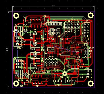

The V3 design continues to evolve since the last post on the subject. We've done away with a separate controller board and are staying with the same concept as with the V2 where a single LDR board can serve as both master or slave based on flipping a jumper. The earlier idea of having 2 different board types added complexity while really not saving much in cost. The key difference between the V2 and this V3 prototype is the adoption of I2C networking which will allow for up to 16 separate stereo channels - way more than will likely ever be used. Meanwhile each board is self-contained so the board-to-board network interface remains a simple 2 wire daisy-chained serial connection.
Being a software driven system, there will inevitably be cause to upgrade the firmware. One challenge with multiple networked boards is we want to avoid having to update each board individually as is the case with our V2 design. With the V3 we want to only have to update the master firmware and then have the master automatically handle updating the firmware on any other slave boards present. That's all doable but we have yet to do the development work.
I've included a snapshot below of the current V3 layout. This will undoubtedly change as we refine the design but I think we'll be able to keep the board to roughly 2.5" x 2.7" as shown with most IC and discrete components being surface mount. That's literally 50% smaller than the V2 board. AND there's no secondary piggyback board as there is with the V2 so this will be a much lower profile board.
Those with an eagle eye and design experience will note 2 voltage regulators side by side labeled 7805 and 317. We don't intend to use either of these established regulators but instead are exploring the use of both our own as well as third party high performance discrete and semi-discrete drop-in regulators that use the same 3 terminal through-hole footprints as either of those regulators. Also, the V3 will definitely use separate digital and analog power.
Morten

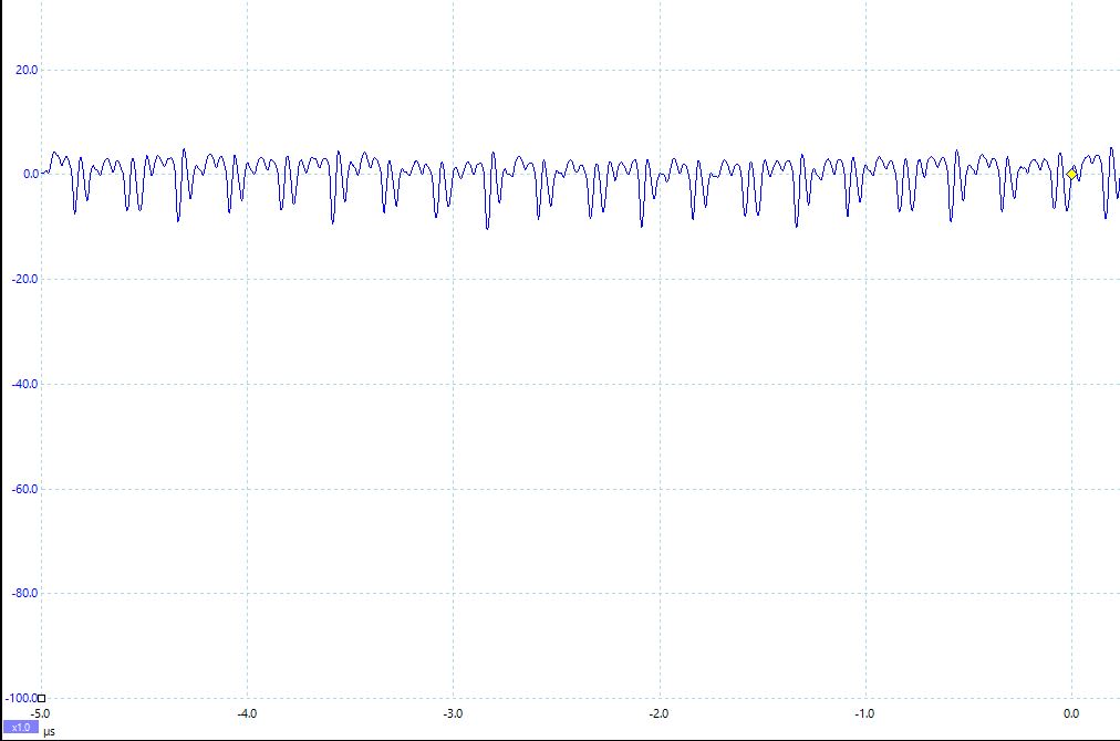

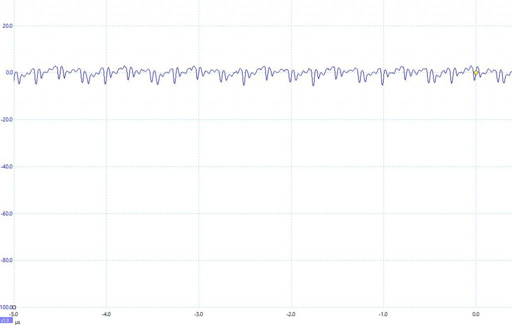

Funny you should mention it. This question of performance on battery has been burning a hole in my curiosity pocket for a while now. Especially since KernelBob went out and bought a big honk'n marine grade battery to try this on his LDR1B.
Yesterday I went out and bought a 10 AHr 12 V battery and have had it running on a Tortuga V2.1 board for the past 24 hours while turned on with dual displays. It went from 12.56 to 12.15 volts over that time period so plenty of capacity relative to load. Tied to a recharge circuit my guess is you could listen to music nonstop for a couple of days before you'd need to kick in recharge. That size battery fits inside the same enclosure as the LDR1B or LDR3.V2.
Today I spent some time taking measurements of the command signal to an LDR under various power supply scenarios. While not exhaustive or definitive I think the following findings are valid:
1) Most of the noise/hash in the control signals to the LDRs is a combination of the 5 V switch mode DC converter on the controller board plus the microcontroller. The DC converter runs somewhere above 100khz and the microcontroller runs at 4 MHz. The net of this is vey roughly +/- 10 millivolt noise way outside the audio band.
2) I saw no change in this whether I powered the board from a 12 V switch mode supply or from the 12 V battery. Keep in mind that the board uses both the raw 12 V supply as well as 5 V from an on board switch mode regular.
3) Next I removed the pricey on board 5 V DC switch mode regulator which has really good specs BTW and replaced it with a cheap (25 cent) LM7805 linear regulator and then ran the board off the battery. This cut the high frequency noise/hash by 50% to 5 millivolts. I suspect that the reduction was due to the elimination of the switch mode regulators switching noise up in the 100's of kHz.
All fine and good but did the battery plus cheap linear regulator help the performance? Honestly, I don't know. It sure sounded nice but then again....it always sounds nice!
Then I ran autocal with the battery/cheap linear regulator to see if anything changed with the reduced high frequency noise. It DID! Autocal ran smoother and faster. This was with the stock autocal op amp and not the upgrade. Autocal being a closed loop instrumentation circuit this makes general sense since signal noise will impact performance.
Too early to draw definitive conclusions but this suggests the unit would be happier with pure DC supply and no switch mode noise. Audible? Too soon to say.
__________
Addendum: 6.22.15
I added the pics below showing the change in the control signal noise. The first one is the "Before" which is with our own 12 VDC supply and the stock 5 VDC regulator on the board.  The second graph shows the "After" when I replaced the stock 5V switching regulator with a cheap LM7805 linear regulator and powered the board with a 12 VDC battery.
The scale on the left is in millivolts and the time scale is in microseconds so each major tic is 1 MHZ. This high frequency noise is no doubt induced by the microcontroller running at 4 MHZ effective with a 16 MHZ crystal.
There's noise that matters and then there's just noise. Arguably, this noise is so far out of the audible range as to be irrelevant. Plus in order for this to be "heard" by the audio side of the LDRs, the LDR photoresistors would have to have a comparable bandwidth which they definitely do not. The reaction time of LDRs to changes in LED current/brightness is a few millisconds and not microseconds. Said differently, the LDRs filter out this noise.
