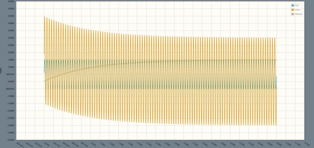

After considerable debate the offset nulling servo is back in. In the end the best sound quality will require direct DC coupling on the input and output (no AC coupling capacitors) and that means protecting the headphones from DC offset voltage/current whether from external source (most common) or internally due to power supply issues (rare but it can happen with split voltage supplies).
This simulation shows a 20 hz  signal (green trace) with the sevo correcting for an initial 500 mv (yes, that's huge ) DC offset and bringing the output offset down to zero. In practice this large an offset needs a protection circuit to disconnect the cans while the servo corrects. That's the next step - designing that protection circuit. Which will require there be relays and a tiny but smart 8 bit protection controller but so it goes. Can't be setting cans on fire!  :thumb:
