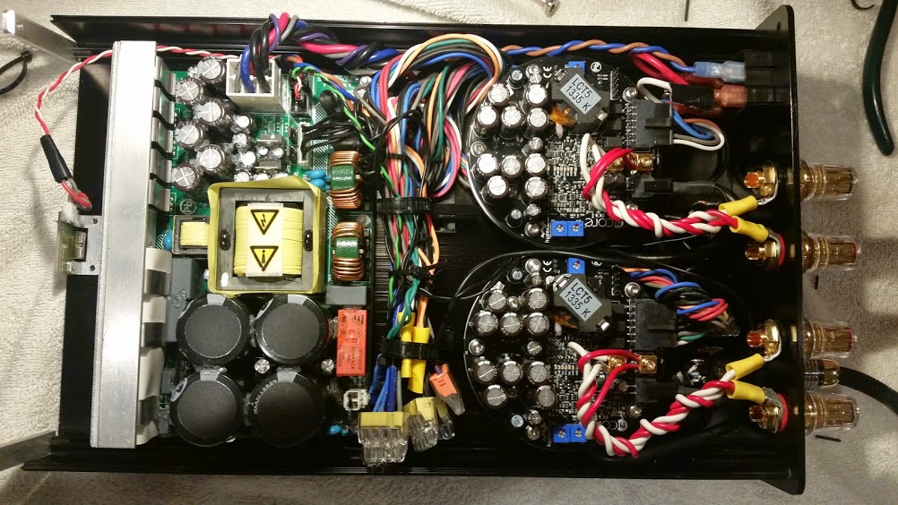

The sharp looking case and a strong US dollar has prompted me to take the plunge in to NCore-land.  Looks to me like the NC400 modules are rather tightly packed in this configuration and am wondering what you think of this layout:
I'm a bit concerned about the following:
* AC lines passing over and somewhat close to the NCore module
* NC400 power input loom passing between/underneath the modules
* Close proximity of the modules to power supply
Is there any cause for concern here, or additional shielding you'd recommend?
Would a copper divider between the amps and PS be overkill?

Aluminum would suffice for a divider. Copper is better in shielding which is a bit different.

Ahhh, good point.  I'm more interested in the shielding aspect and whether it's even warranted in this case.

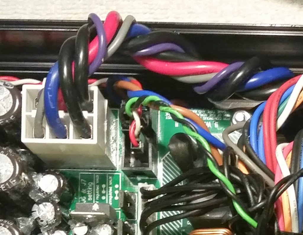

I have a slightly longer (deeper) version of it to support dual SMPS600 if I want to replace the SMPS1200 with the dual. Ghent is happy to support me with that (with small additional cost).
nAMPON and nFATAL are connected to the SMPS1200.
Here a picture of it.
Please comment.
Do you feel that any shielding is needed here?
I realize it's a bit of can of worms with the different possibilities and merits.  I've read up a bit on ERS cloth, foil tape, and copper dividers...   Just not sure whether it's an issue that even needs to be addressed.
Thanks for replying.
I unfortunately can't make out all the connections in your photo.  Could you clarify which specific pins / locations the NAMPON and NFATAL leads are connect to?  I thought NAMPON needed to be grounded or routed through a switch in order to mute.
I'm also curious which SMPS1200 (A400??) J5 pins you used for the LED switch?  I believe I it was 3 and 5 in either orientation.
I do plan on reviewing the proper assembly method in the coming week.  Would be great if you could help clarify things as it appears you have the identical setup.
Thanks!

Yes I use a SMPS1200A400 to supply both nc400s.
nAmpon  connects to J4.6
nFatal (green J7.5) connects to J4.10
Led connects to J4.1 and J4.3

Green (J4.10) connects to nFatal (green - both nc400s)
Black (J4.6) connects to nAmpon (black - both nc400s)
Red (J4.1) and White (J4.3) connects to LED
