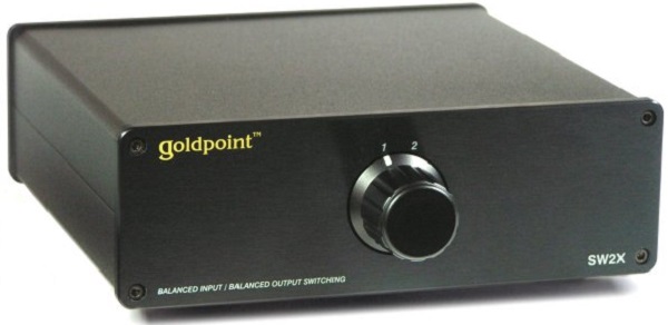

To my knowledge Bryston does not make a line level switcher.  Although I'm sure there are less expensive ones to be found, one high quality switcher would be the Goldpoint SW2X-0.
Steve
R. Daneel
  • Posts: 1181
Steve
Hi Steve!
This is EXACTLY what I need!! Thank you very much!!!
I have one question though - this Goldpoint should be a passive device then, right? No power supply is required.
Best wishes,
Antun
srb

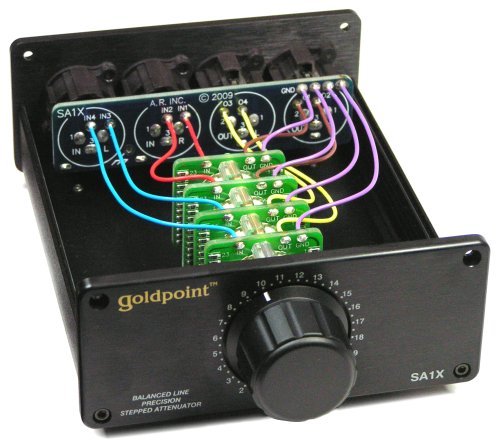

Yes, just jacks, wiring and switch.
I couldn't find a photo of the interior of this particular model, but the construction would look similar to this SA1X passive volume control with with a selector switch instead of a stepped attenuator and 6 jacks instead of 4.
Steve

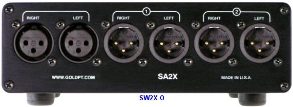

srb
I was just reading about these passive preamps... Would something like this work in-between the BDA-2 and a power amp for instance? I suspect the performance would be heavily dependent on the BDA-2 output capability to drive a power amp directly, right?
Are you thinking of possibly eliminating the BP-26 and and using a switch to go direct to power amp for speakers and to the BHA-1 for headphones with only a single source (BDP-2)?
If so, the Goldpoint units are not remote controlled, so you would lose remote volume feature with the speaker setup.  You could test the BDA-2 direct to power amp if you have a way to digitally attenuate the source.  I don't know if the Bryston or 3rd party software for the BDP-2 offers volume control, or you could temporarily try a PC or Mac as a source into the BDA-2 using the computer system volume control.
It wouldn't be an exact apples for apples comparison because you would be using digital volume control versus analog volume control, but it would let you see if the BDA-2 would properly drive the power amp and what might or might not be missing when eliminating the BP-26 active gain stage.
In either case you would want to be VERY CAREFUL and be sure that the source is properly digitally attenuated so you don't accidentally unleash the full fury of the power amp to your speakers.  There's a certain sense of safety when you have a good analog potentiometer or stepped attenuator in the middle, knowing that a random software glitch or static discharge won't accidentally put you to full volume!
If I'm reading this possible scenario correctly then the Goldpoint SA2X-0 would combine the switcher and a stepped attenuator.  But if you need remote volume or need to accommodate multiple sources, a more full-featured passive "preamp" would be required.
