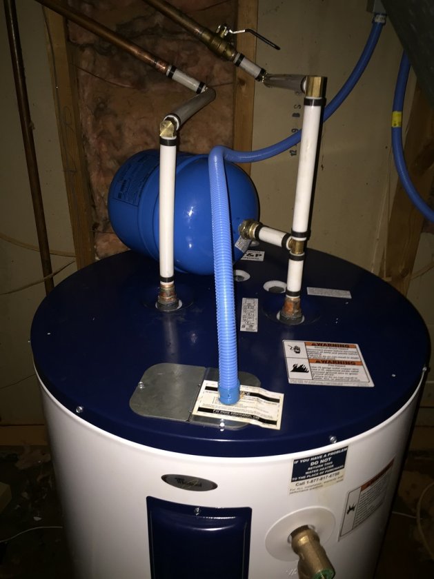

There is a Die electric union that can/need's to be installed on the lines. Since folks tie the electrical ground to a water line the water heater becomes a lab experiment.Some City's have started out to out law using water lines for grounds so the water mains don't look like you hot water heater. Try working on the meter in the front yard when there is aground issue in the house I have a neighbor that is a electrician for a neighbor and his hot water heater looks like a lab experiment.And then there is my house where they have 18 inches of copper in the dirt and they use that for a ground. They also tie onto the re bar in the footing for a ground. There isn't that much of a footing/stem wall.
