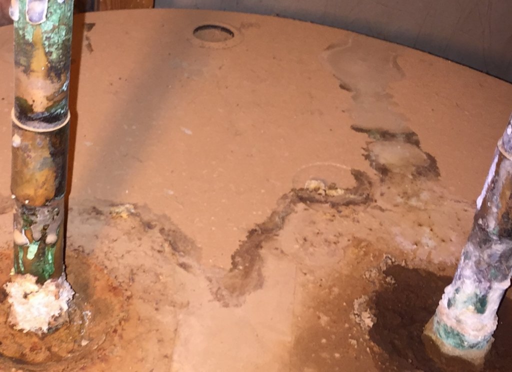

Hi guys,
This is my Kenmore 40 gallon electric water heater. Brown residue now seeped into in a large patch of carpeting with padding. Luckily it sits on a cement slab floor, in the middle of my lower level of the house.
Noticed the carpet was wet a few days ago and thought it was some bottled water I had tipped over. Not sure for how long it had been leaking. Intelligent me had stacked a bunch of stuff in front of the door to the closet in the middle of a slab floor.
So I am thinking this is not a repair? who knows how deep the corrosion goes, right?
I have shut off the intake valve (you can see the edge of it) so I am thinking I can at least use the cold water while I am deciding.
This is a $300, 40 gallon electric Kenmore. I have been very happy with the performance, I keep kept it just at scalding temperature. It holds water hot enought to take a shower for 2 days, when the power goes out for multiple days (has not happened in my neighbothood for years now, thankfully).
Oh and it is 18+ years old!!!
To replace would be $300 + labor, delivery etc = $600-700?
Do I want a tankless electric water heater instead?

Definitely not a repair! Replace!.
"Do I want a tankless electric water heater instead?"
Tankless electric water heaters are generally only for minimum flow installs, like serving a single sink. The Aquastar units appear to be gas only. Bosch does make 2 Powerstar whole house electric models, but they requires either 2 or 3 (depending on size) 40 amp(!) circuits @240v, an expensive install.

Your problem could have been caused by electrolysis from the plumbing pipe to water heater connections.
Make sure when you install the new heater good quality dielectric water line to hot water heater connectors are used.
http://www.plbg.com/forum/read.php?1,527275
http://www.doityourself.com/forum/water-heaters/172766-rust-water-heater-pipe-need-replace.html

Thanks, I was actually wondering about some weird annode cathode action looking at the pipes, since I see that kind of corrosion. In the original iPhone photo you can almost see crystals.
I had replaced the breaker for the hot water heater several years ago because it had white corrosion in it and was not conducting ( I thought my annode was dead and replaced it first by mistake). Could I have something seriously wrong with my wiring here? The previous ownder did a lot of half-assed DIY stuff courtesy of his friends, like no GFI circuit on the hot tub. Every year I seem to have to deal with  something stupid that was done.

I vote for the new tank. By the way, the "plumber" who did the soldering job on the incoming and outgoing water lines should be shot or they should go sell shoes for a living, you should never see evidence of solder joint leaks as appears in the image you posted.
 You definitely got your moneys worth out of the old heater. After your plumber installs the new tank you should invest in a fiberglass blanket for the new heater, it should save you some money in the long run as utility rates will not go down in the future. These should be available at Home Despot or Lowes.
I didn't catch that the water lines are run directly into the tank, there should be a flexible line with electrical insulation to prevent that... there are issues with electrolysis that may have also effected your electrical lines. Besides the breaker the wire going from the breaker to the heater should probably be replaced too. Not exactly the same, but I have found battery acid corrosion on car electrical very far away from the battery (right next to the fuel pump on a Suburban) that caused the wiring to fail.

There is a Die electric union that can/need's to be installed on the lines.  Since folks tie the electrical ground to a water line the water heater becomes a lab experiment.
Some City's have started out to out law using water lines for grounds so the water mains don't look like you hot water heater.  Try working on the meter in the front yard when there is aground issue in the house :cuss: :cuss:
I have a neighbor that is a electrician for a neighbor and his hot water heater looks like a lab experiment.
And then there is my house where they have 18 inches of copper in the dirt and they use that for a ground.  They also tie onto the re bar in the footing for a ground. :scratch: There isn't that much of a footing/stem wall. :scratch: :scratch:

Electrolysis has nothing to do with whether the hot water heater is heated by electric or gas.
http://www.finishing.com/246/64.shtml
http://www.plainviewwater.org/Approved%20Copper%20Pinhole%20PR%20Response.pdf

You've got two types of corrosion going on there. Green stuff is from solder flux that didn't get cleaned off. Hairy white stuff is likely galvanic corrosion form not being electrically decoupled via flex connectors mentioned earlier. Plumber probably thought he was doing something good, but I've encountered some pretty dense plumbers. You've also got a dip tube anode inside the tank that's probably history, but doesn't matter at this point.
You may also want to consider an expansion tank if you don't have one. Some codes require them on new construction. Here's a rudimentary explanation:
https://www.youtube.com/watch?v=qufLEIh6LF0
Get a tank, a better install and call it good.
