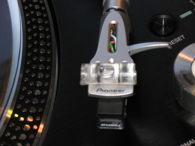

Mounting the AT440MLa presented no problems, however, any shorter slot length and I would not have been able to put it into Baerwald (Lofgren A) alignment, which would have been a deal breaker. Hint to Pioneer, make slots longer towards the end of the headshell.
I then did the bubble test for azimuth smear (which basically means that the tonearm vertical pivots are parallel to the alignment. While the table wasn't level at this point, the test did prove that the engineering was correct.
Cue up:

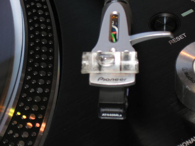

Next, I could not achieve a parallel arm with the AT440MLa and the supplied mat, so I added mine, which is 3/32" thick (.094), 50 durometer open cell sponge EPDM.
I set the VTF using the old fashioned method of zero balancing, then zeroing out the dial, then setting it to 1.6 grams. I then used my calibrated digital scale and weighed the results, off by .06 for a 1.66 gram VTF. Close.

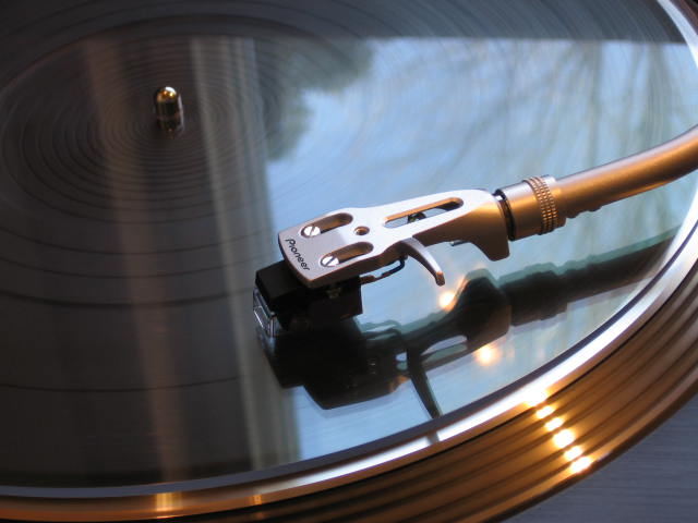

Next it was time to set anti-skate. As some of you may (or may not know), I use a blank disc to do this. If you do not like this method, that's fine with me, but it does show if the AS is working or not. At the recommended 1.6 setting, the arm ran to the spindle. I had to actually bring it up to 5.1 to get the arm to sit on the disc without movement. My Technics SL1200MKII is only slightly higher then the recommended setting (at 2.1) with this test. The good news is that I still had enough travel on the dial to get to where I wanted.
Photo of table running, stylus on acrylic disc, arm stands still:
