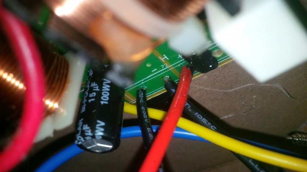

Pics of the Surround speaker crossover.

Yep, can't see in the box too well, but I do see a resistor and potential something else??
Based on no more than you know or have to work with, I could not advise just up and changing values.  Even though, going from a 6.8uF to 3.3uF on the center tweet might help that driver with resonance.  But you can not just up and change values on a well designed speaker (of which we have no idea what we have here).
Make sure that there is only a cap, coil, and resistor in there.  On the surrounds, use these:http://www.soniccraft.com/product_info.php/kimber-kap-33uf-200vdc-p-4652.  On the center, use a Sonicap G1.  Replace all the resistors with Mills 12 watt: http://www.soniccraft.com/index.php/mills-12-watt-c-29_53_63.  If you do not have solder, this will make easy work of it: http://www.soniccraft.com/product_info.php/cardas-solder-qe-24ft-p-521.  These recommendations are based on your budget and desired results.  As far as you were able to translate to me...  If you decide to experiment with the center from here, it will be a single cap.  It will be cheap, and you will have a new bench mark to work from.  What you have now leaves you in the unknown.
Looks like we have more going on here.  I'd recommend removing the XOs altogether.  You are going to have to do this at some point.  To be clear, is it only the center with the lisp?

As I have said above, caps will certainly influence the sound of the speaker (much more than many are aware).  Yes, they will improve them.  Right now, I do not know much about your XOs.  You seem to be in the dark too.  Your picture are revealing more than you have told me.
No rush.  Once you have them out, take detailed pics of both sides.  If we can not figure it out that way, you can mail one of each to me.  We will evaluate, measure, and draw a schematic free of charge.  You will have no obligation outside of return shipping.
BTW, are all the surrounds MTM floor standers?  How about a pic of the center?

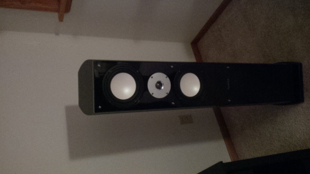

Here is the pic of the Center. I guess I didn't realize I was talking to the president of SonicCraft either... :)

The crossover in the picture is using decent air-cored inductors, but the capacitors look cheap. Instead of changing the values, replace them with something quality. Even the cheapest MKP's from M-cap would beat these. find a friendly shop that allows you to try different values, start with same values as they are, just do not solder them in, if you intend to change them, use clips.
You have to be careful here.  While they would be more detailed, and have a longer life, they would be harsh and edgy.  Those are basically SCRs...like Solen.  At least the electrolytics side towards the dark.  Many have learned this lesson.  You see their posts, "I love the detail, but I hate to listen to them".  Or, they love the detail, but they are back working on them a few weeks/months later.  Sometimes, you see them up for sale in short order.  I suppose some just live with it not knowing any better, but I definitely do not recommend the cheapest Mcap MKP for anything other than budget lowpass shunts (read this as large value LP shunts).

One problem I may be experiencing is the fact that they are MTM's and that the tweeter is in between midranges and I'm not use to it. From what I read is that a MTM design is more simplistic in sound, and they do filter Piano sounds more realistic that a TM speaker cause of the lobe tilting effect. :) My car has the Pioneer tweeters on the side, and it's great for loud music and all. :) The reason why I choose these is because the we're the cheapest, good looking speakers I could find at the time, and now that I got a little tax return, I want to up the ante with them.
