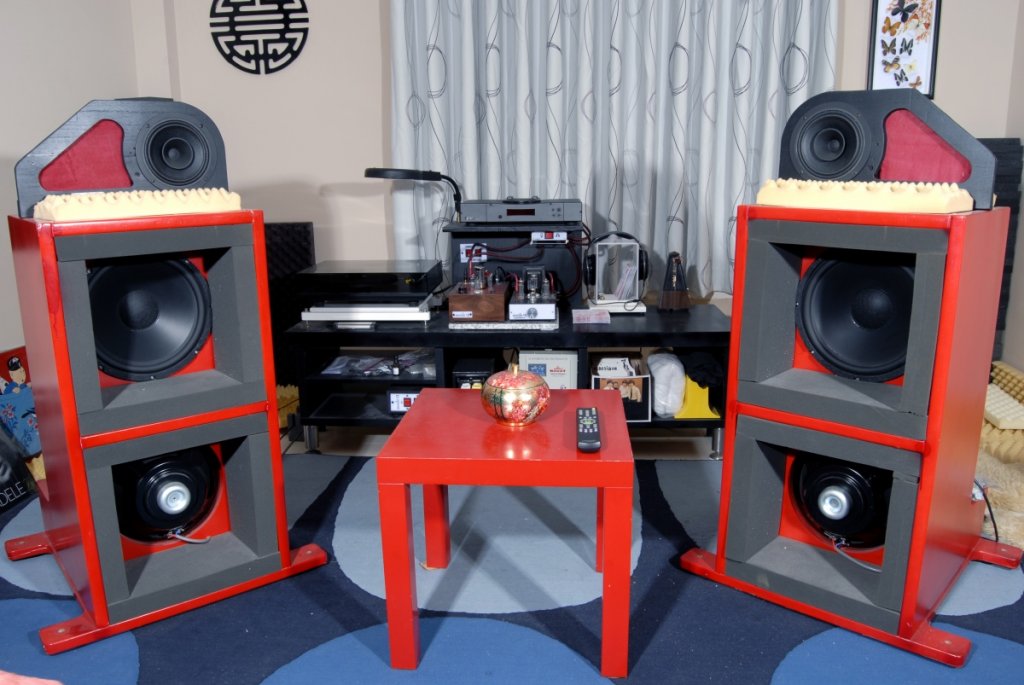

my Omega 7F Open Baffle Dipole are 93dB efficient.
I have a Decware SE84C+ SET that can put out 2wpc,
therefore the music would be 96dB (??) at one meter,
but I am sitting at 2 meters away from the speaker,
so that would put into my ear about 93db,
that's quite loud and it's loud enough for me !
Considering that the normal and safe for the ears listening level is around 80dB,
then I will say: Yes, the full range driver can play loud, how loud?
Loud enough for most Audio Circle members.
Please feel free to make any corrections on the numbers above.

Here is my set up anyway:
Sitting position 4' from speakers.
4.5' between the two speakers.
6.5' behind the speakers,
because they are Open Baffle Dipole, so they need space.
My listening room is 12' wide, 13.5' long and 9' high.
If I had to do it all over again, I would go again with Omega (93dB)
with this time a 6wpc Decware amplifier and a pre-amplifier, some recording (CD) are recorded below average, so with my 2wpc, with those recording I need to push the Decware 2wpc to it's maximum, therefore, missing headroom.
For the subwoofer, that's really a matter of how do you like bass, how loud you like your bass, but for me, I could not live without sub woofers, however, with Omega floor stander and some lite music like jazz at reasonable listening 80 to 85dB subs are not a must.I bought a frequency generator and a dB meter from Amazon and did my tests, it's not the best way, but I does tell you a little more that having nothing to test.
I hope this help.

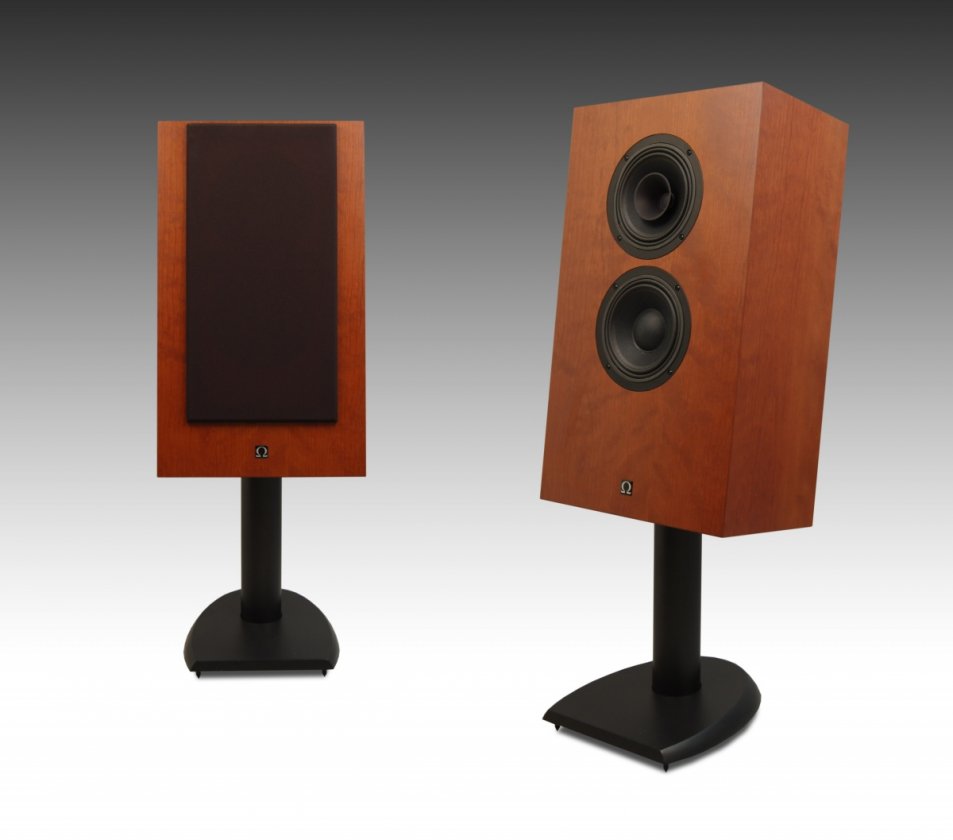

Thanks and these play louder and I will be expanding this concept. This particular model is 100dB. Surface area combined is about the size of a 9" driver. Easily capable of deeper bass in a Floorstanding configuration.
Thanks again,

Is that a 4 Ohm speaker?
steve

It is a 4 ohm speaker as I'm using them with a 8 watt amp at the moment.
  I only have 25 hours on them as of today but superb but I haven't pushed them at all, not even 1 watt worth and they go plenty loud.

Thanks and it's 4 ohm, but an easy 4 ohm. I've use them on all my tube amps and no trouble at all. If this concept goes forward in a set line I will consider building 16 ohm drivers to get the system into 8 ohm rating.
Hi Bill,
Great news and they were terrific with your 8 watt integrated. Combo was superb and I never went pass 11 o'clock on the dial.
Louis

I recently spoke with Louis, and I'm close to going with the Outlaw speaker you have.  How would you describe the weight and presence in the upper bass/lower mids?  As I told Louis, I'm looking for a pair of speakers that sound convincing with kick drum, the low tom, and low end of the Cello.  Your thoughts would be appreciated.

Which Outlaws?  And why Outlaws?
You're looking at frequencies down to 50 Hz.  By Louis' numbers any of the 6 inch or 7 inch monitors/towers and the 3XRS would work, so I suppose any of the Outlaws would work too.  But beyond the numbers, bigger drivers push more air, which is important for "convincing" bass.

JLM - I'm referring to the speaker on the stand in the photo that Louis added a few posts up.  Those are the speakers that Bill is referring to in his post.  It's the speaker that Louis said would be the best for what I'm after.  I just wanted to get Bill's perspective as his set breaks in.
