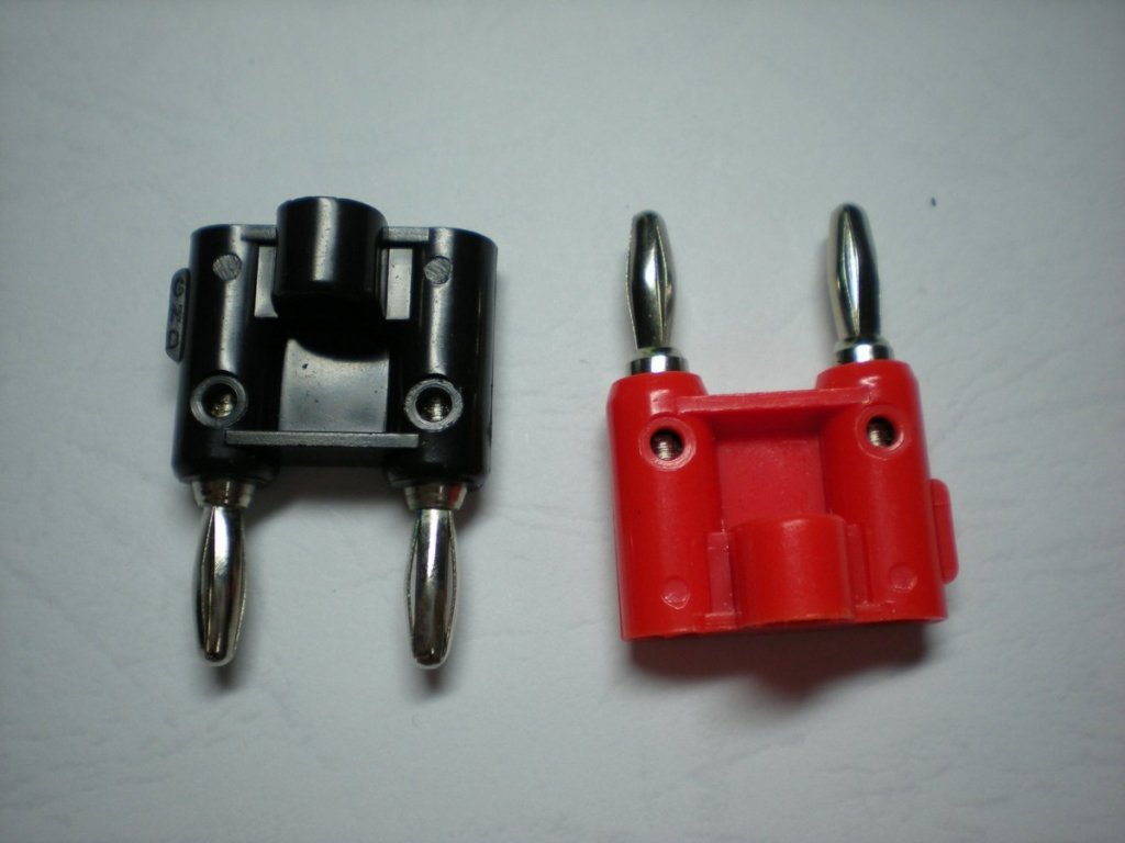

Oh…and for quick and easy speaker connections with the 2BLP pro these come in really handy. :thumb:
