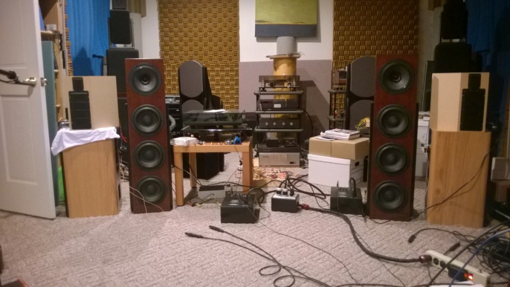

Got the Monolith 8" full range with 3x8" servo woofers with the Rythmik HX300 amps running yesterday with the dspMusik 6x8 as the digital crossover.
Used lots of techniques to flatten the response.
The OB next to them are the prototypes of the powered desktop speaker using the BG NEO3/NEO10 combination.   Both sound very good, but very different.   Once I have the 3x8" servo H-Frames from Ruben built, will get those setup as well.
HAL
Have Room EQ Wizard running on an MS-3 working with the dspMusik and a Dayton Audio UMM-6 calibrated mic for room measurements from the listening position.  The dspMusik is running as both the crossover and measurement output.
After the measurements REW can generate data for Parametric EQ on the bass driver channels.

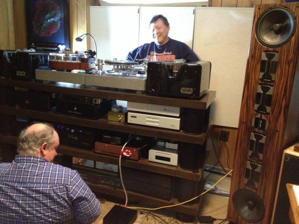

Scottdazzle
Here's a shot of Rich and Rim fishing cables for the MS-3 and dspMusik session.
 Rich
HAL
Scott,
Great picture!

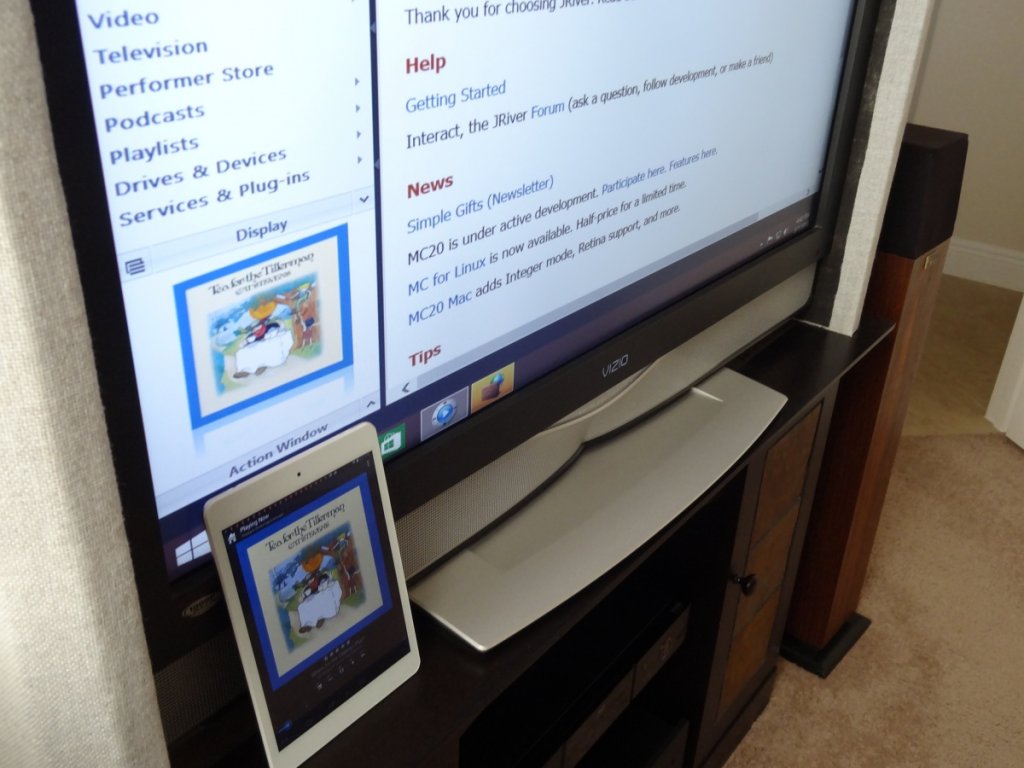

Got the Gizmo App up and running on my cheapo Android Tablet.  Only used it a few minutes but so far I do like JRemote on the iPad mini I have in the main system better but it's hard to argue with free and it allows you to choose music in the same manner as JRemote.  Below is a shot of my Tablet and leaning against the monitor.  It is a small bedroom system but sounds quite good and it's nice to have an easy to use product like the MS-3 running established software for music files vs. something proprietary where one sees posts all over the web about daily difficulties with the software.  Thanks, Rich
