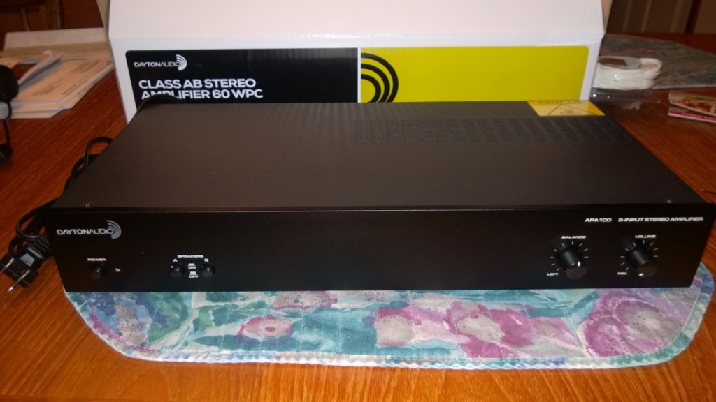

For the LS-9 crossover measurements, here is the Dayton Audio ADA100 stereo power amp that will driver the passive crossover with Pocket CLIO as the measurement system.
The unit has 60wpc and 5-way binding posts to make it easy to connect to raw wiring of an external passive crossover for measurements.
As noted by others, it is important to have the speaker driver load on the passive crossover to get the correct frequency response plot to emulate digitally.
Will setup the measurement suite with a passive crossover to demonstrate the technique.

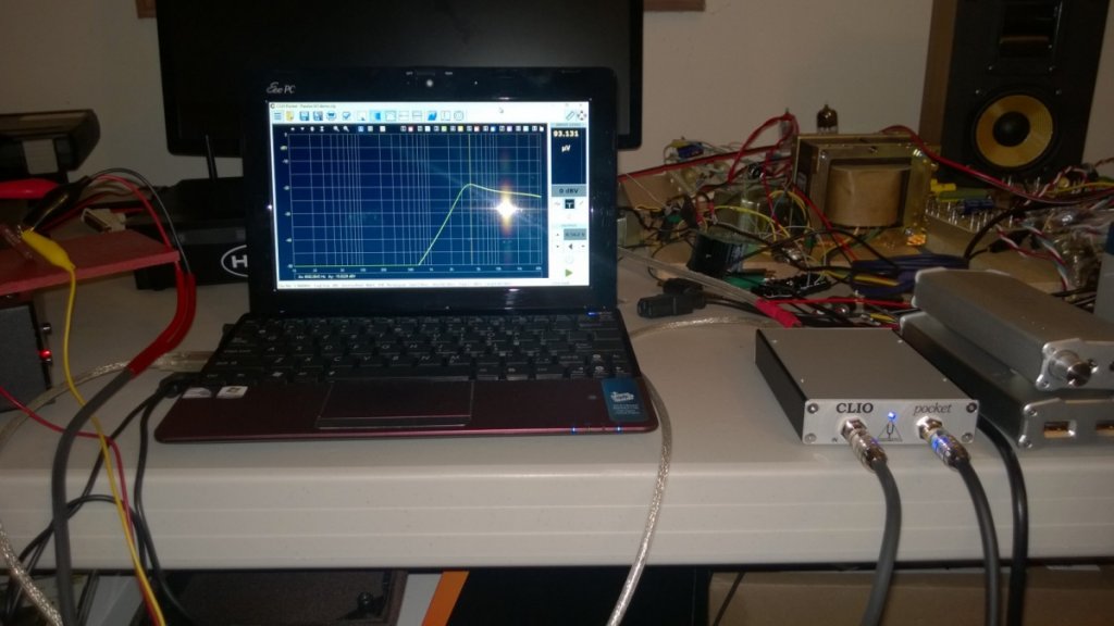

HAL
The Pocket CLIO measurement system is working and made it's first passive crossover measurement.  Wrote an instruction guide to go with it, so the user can get the measurements needed to create a digital crossover from the original passive crossover in the speaker.
Will be packing the system up and shipping it to the LS-9 owner to do the measurements on his speakers.
