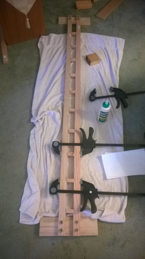

HAL
The glue for baffle #1 stringers is drying. After about 30 minutes will start baffle #2 stringers glue work.

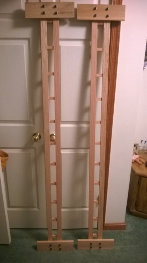

HAL
Front baffles completed and glue drying overnight.

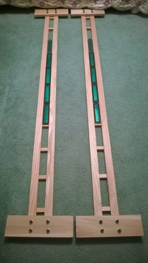

HAL
Test fitting the FPS planar drivers after the glue dried overnight.  A bit of sanding and then time to drill a lot of holes to mount the drivers.

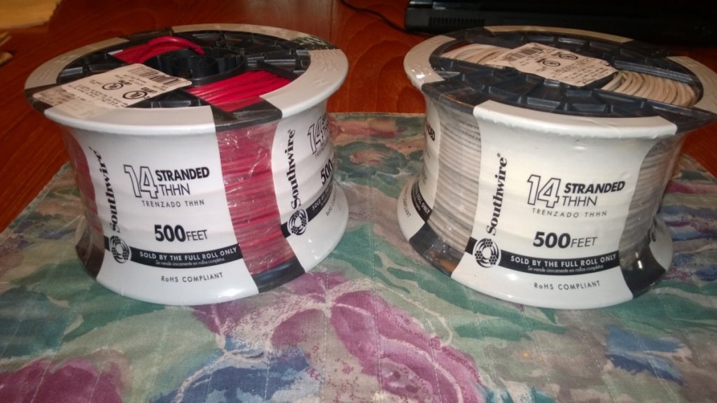

HAL
Since we need speaker cable to wire up the line array, here is 500' of DIY 14awg stranded speaker cable.

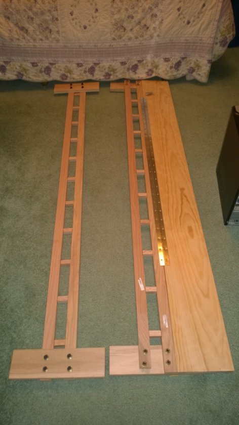

HAL
Side wing attachment beginning.
HAL
The THHN 14awg stranded wire will not lay flat for cables.  Have Belden 1309A on order to replace it.
