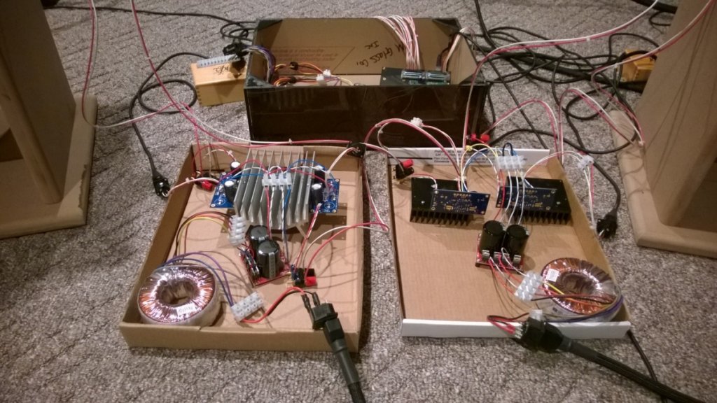

The demo MS-3 and dspMusik system are on the way for trials with LS-9 speakers.  The customer has MS-1 Music Server's in his setup running Windows 7 so he will get to compare it to Windows 10 running on the MS-3 and dspMusik as a DAC to start.
All the modified ChipAmp modules for the open baffle line array idea using the FPS drivers are completed.

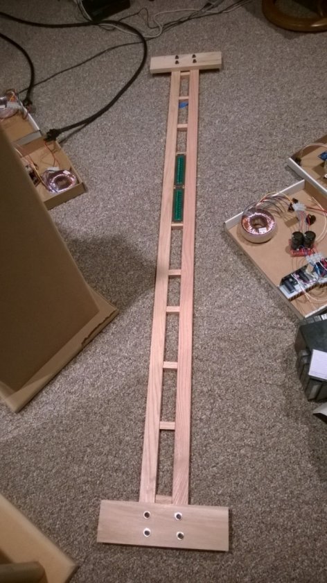

First part of the open baffle line array for the FPS planar drivers is done.
Now to add horizontal stringers and the side wings.

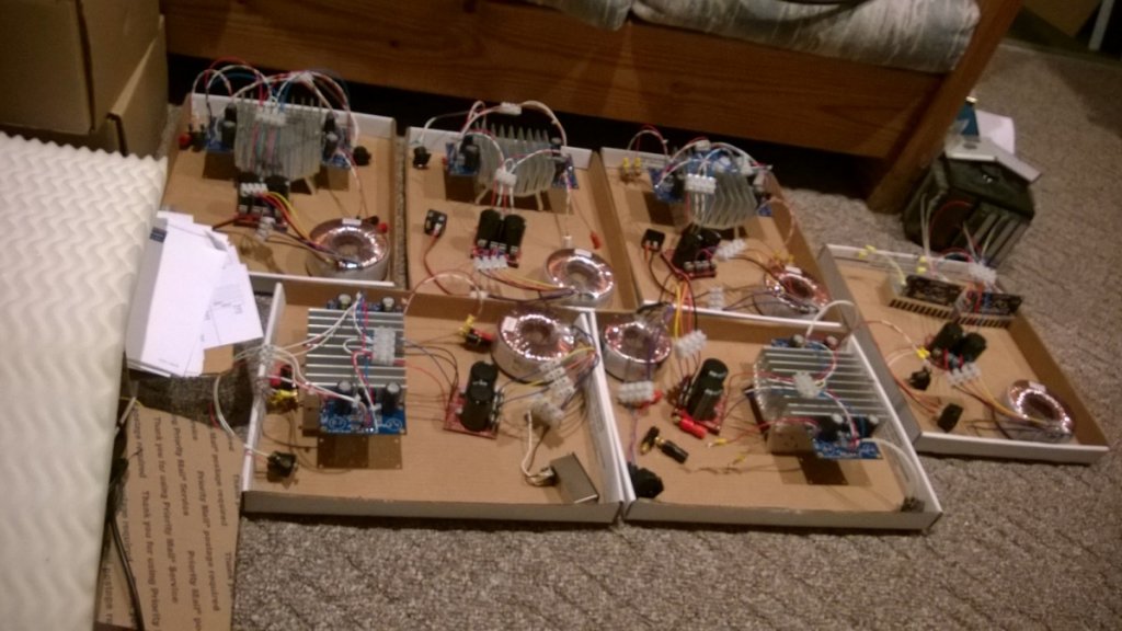

Eight modified ChipAmp's ready to try with the MS-3 and dspMusik.

Lots of soldering and wiring to get the ChipAmp modules for the line array's built and working.  Fourteen channels built and most tested.

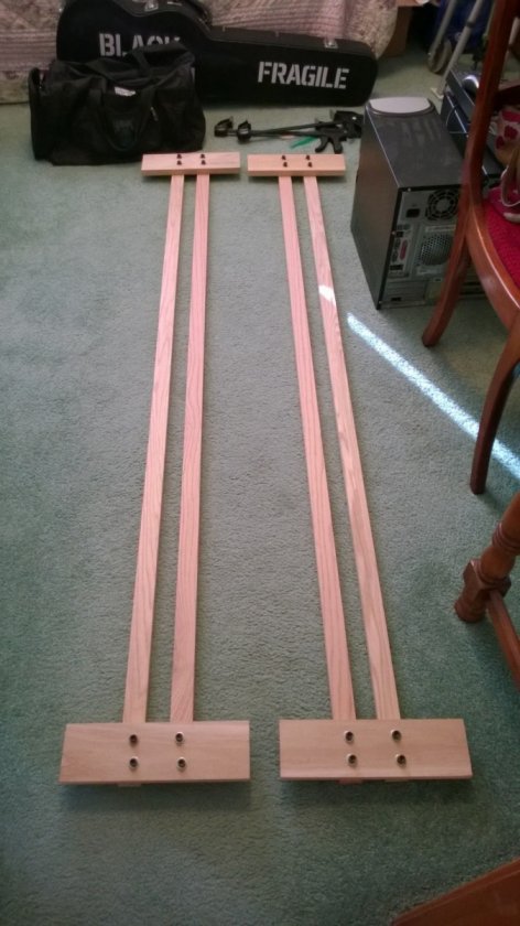

Oak stringers cut and ready to glue to the baffle to mount the FPS planar drivers.
Next drill the holes to mount the drivers, add the wings and wire up the drivers.
