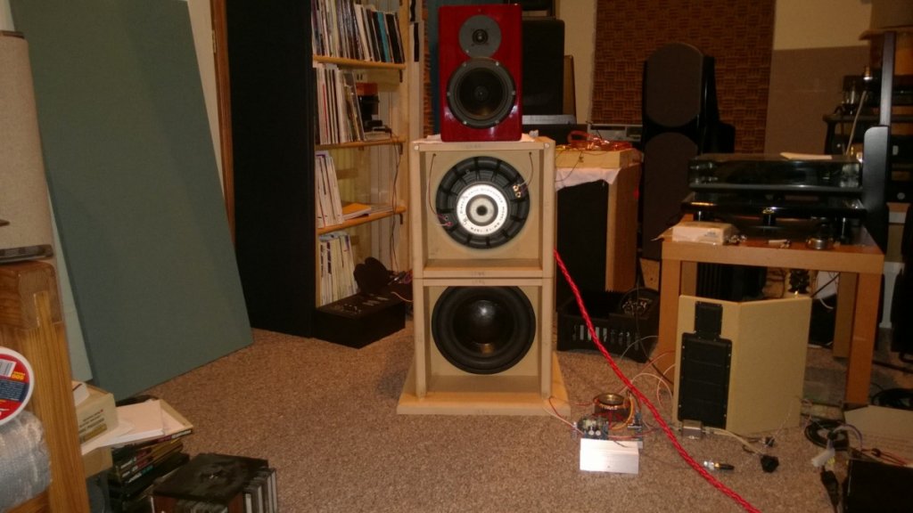

The HX800XLR3 servo amps are up and running with the 2x12's.
Hi Rich,
1. Are you using SW-12-16FR drivers with the  HX800XLR3 amp. I'm planning to build either the H-Frame or the W-Frame. I was going to use the A370 amp but since there are two drivers I can see your reaasoning.
2. When I was emailing Danny, I mentioned that I would be using a DEQX Express II processer with the speakers. He suggested that I sell the DEQX and contract you regarding your MS-3 system. I also do digital audio recording and I've built a few computers so a computer system appeals to me. I would like to learn more about how you do dsp room processing.
Charles
HAL
Hi Charles,
For the 2x12 open baffle servo subs, the Rythmik A370PEQ is more than adequate to drive the SW-12-16FR servo subs.  I am using the HX800XLR3 with the large 6x12 open baffle servo sub array I am building.  You might ask Danny if the SW-12-8FR's would be a better match to the A370PEQ than the -16FR's in the 2x12's.  If you were going to more 12" drivers the HX800 might be a better way.  Each HX800 amp module is driving 3 - 12" servos in my setup.
The dspMusik is a 6 input (USB2, S/PDIF and A/D), 8 output DSP and HiRez DAC system.  It works as both a digital crossover and PEQ system for the setup.  I use Room EQ Wizard to make measurements with the MS-3 and dspMusik and then setup PEQ's in the woofer or sub processing.  Time delay can also be added if needed. The user can make measurements and I can setup the PEQ's and send the block diagram for AudioWeaver to run.  I use a Dayton Audio UMM-6 calibrated mic for the measurements with REW, as they are $85 and have calibration files compatible with REW.
There are other ways, but I have to see the processing power available in the MS-3 and dspMusik will handle it on a case by case basis.
