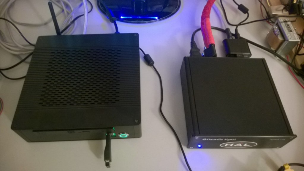

The Uptone Audio USB Regen amber version connecting the HAL MS-3 and dspMusik.
The USB Regen has been on for two days.  Will be checking it out soon.
