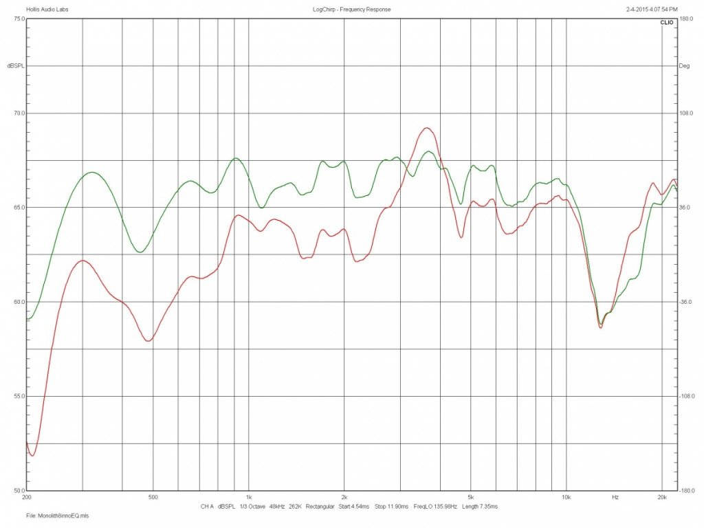

Here is a comparison of a 8" full range drive in a open baffle U frame with 3x8" servo woofer being driven by the dspMusik.  The red graph is the unEQ'd speaker.  The green graph is the same speaker running EQ to correct the response plot.  There is no correction added to the dip at 13KHz.
Using two channels of the unit, one with the EQ for the 8" full range and direct couple for the 3x8" servo woofers.
All processing is with the 40bit floating point 192KHz sample rate software.
No linear phase filtering is used in the EQ or DAC outputs.
