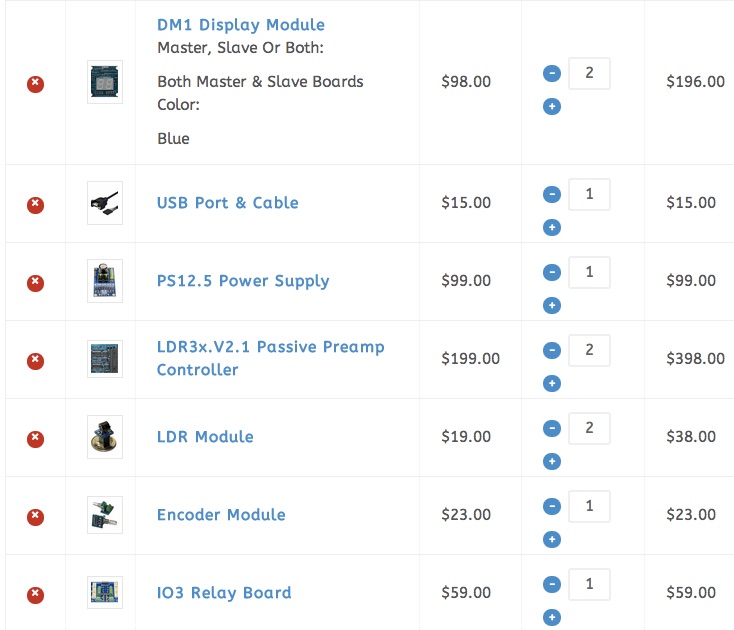

Are these the parts and quantities required to build a Balanced Tortuga?  I would not want SE inputs or outputs.  Of course, enclosure, connectors, wire and remote are needed.

In the same order.
Display Module - both master/slave - $98 (highly recommended - you only need 1 set of these, not 2)
USB Port & Cable - $30 (recommended - you'll need 2 of these, 1 for each board)
PS12.5 Power Supply - $99 (optional, you can use any 12 VDC supply source including a wall-wart etc. )
LDR3x.V2.1 (must have - 2 boards) - $398
LDR Modules (optional - V2.1 comes with essential 4) - $0
Encoder Module (highly recommended) - $23
IO3 Relay Board (highly recommended - 2 - need one for each board) - $118

In the same order.
IO3 Relay Board (highly recommended) - $59

« Reply #9 on: 25 Jan 2015, 05:34 pm »
Hello Morten,
I asked the same question a few weeks back and you recommended 2x IO3 modules to handle the multiple inputs/outputs.  Wouldn't that apply here as well?
I'm also curious if you could weigh-in on the approximate length, gauge and type of hook-up wire needed.
Gracias!
Ah, you are correct. An IO3 is needed for each board in a balanced configuration with multiple inputs. I will amend the earlier post accordingly. Thanks.
