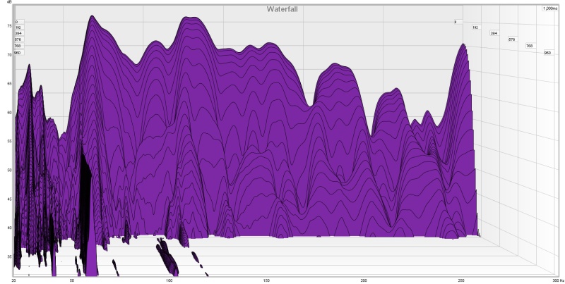

A rather productive if confusing morning.  I took about 40 waterfall measurements with REW, most with all but the semi-permanent acoustic treatments removed.
Here is the baseline measurement for the listening position.
Listening position, no treatments
Listening position, MT and soffit traps installed--they don't seem to do much...
Listening position with 2 monster traps and 4" DIY 703 + mass-loaded vinyl trap stacked vertically behind listening position.  Now we're getting somewhere, but it took 18" of high density fiberglass plus mass loaded vinyl, and the effect is only local.

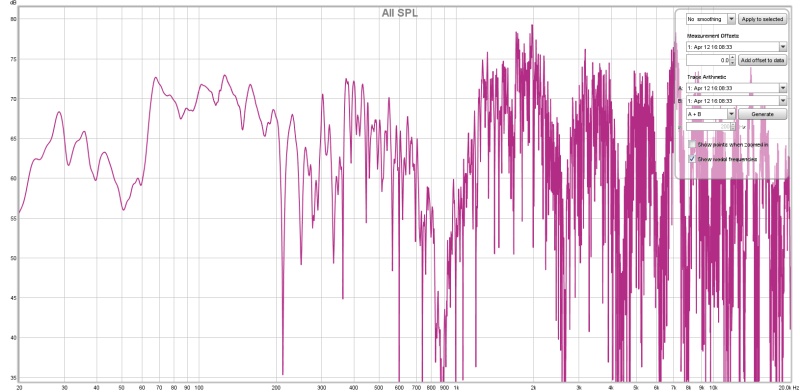

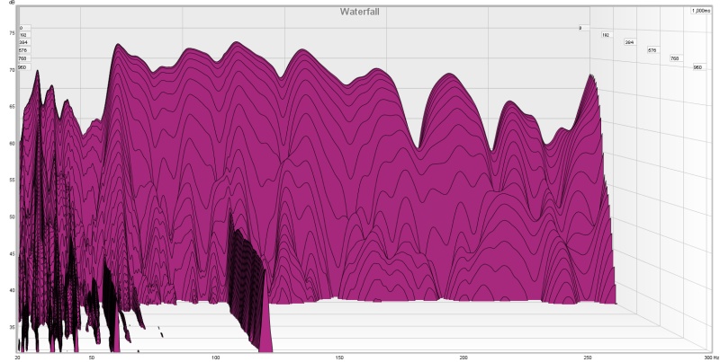

Got a chance to take a few measurements last night with the two additional traps in place and things look to be getting better.  Each measurement is the average of two full-frequency sweeps.  Note that there is no smoothing on these, so the frequency response graph in particular is pretty ugly.  I'd appreciate recommendations on the best way to look at both the waterfall and frequency response curves.
The waterfall definitely seems to be improving with the two additional traps, and looks about as good as the case with 16" of traps behind the listening position.  There's still a pretty big null at 47 Hz.
The frequency response graph is interesting.  Again I'm primarily looking at <300 Hz at this point, but there's a huge null at 890 Hz.  I don't hear this null, and I think I would if it was really there and as big as it shows up.  Could it be an artifact, or do I really have that big of a suck out?  Interesting differences between L (blue) and R (Gold) speaker responses, which made me want to investigate BRM's suggestion to move the speakers a bit.

Moving the speakers definitely had an effect.  More optimization is necessary, but I can definitely modulate the 47 Hz null with speaker placement.  Moving the speakers closer to the listening position and narrower didn't do mucn...
...but keeping them about 3" narrower on either side (6" total) and moving them back 10" (9'1" from the listening position as measured with a laser) from the original position had a pretty big effect.
The frequency response also looks smoother, at least in the bass.  I still see the huge null at 890 Hz, but I'm making progress.

I did one more test this morning.  Using the sine wave signal generator, I swept the frequency slowly from 800 Hz to 1000 Hz.  While I can hear some variation in level in that range, the signal does not disappear as I'd expect if there was really a 40 Hz null at 890 Hz, so at this point I'm writing that off to a measurement artifact.
Glenn Kuras
  • Posts: 463
Re: Room Treatment Progress
« Reply #35 on: 6 May 2015, 04:57 pm »
Just from looking at the graphs I really thick you are right about the artfact.
