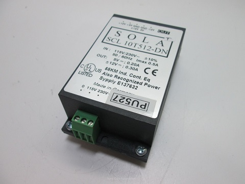

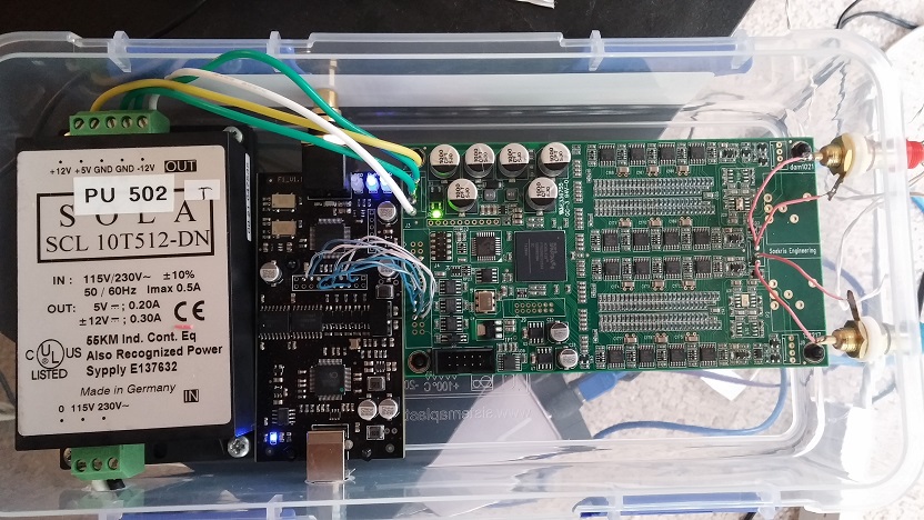

Just fired up my Soekris DAC. It is f*cking great :o 8) :icon_twisted:. I took a minimalist approach:
Soekris DAC .5 resistors Rev 3 ($195)
SOLA Power AC/DC 12v Linear Power Supply (<5mv ripple, $30 ebay)
Singxer F-1 USB/SPDIF/I2S Converter ($180)
The Rev 3 boards incorporate mods that evidently elevate the Soekris well beyond the initial version. So the only mod I have done is remove the output opamps. Two of the opamps are glued tight with pads underneath so they were kind of a pain to remove, so approach with care. DC supply is what's recommended and people are using all kinds of ways to power the board. I chose to keep it simple to start with. The SOLA is compact, well made, easy wire up and has great specs. Highly recommend used linear supplies like these on ebay, they are inexpensive.
I've raved about the Singxer F-1 in C&C. Just get one. You won't regret it. The plus side of the Singxer is you can wire the I2S connection straight to the Soekris, including power, so you don't need to worry about buying/building a usb/coax/toslink input and figuring out how to power it, etc etc. Easy peasy.
How does it sound? Frickin' excellent. I can hear the appeal for R2R/ladder DACs. This does not sound like anything remotely budget. The realism, dynamics, man, wow. Kind of like live performance. Glare-free, low noise floor. I mean, it makes you shake your head at amazement in how much information is in redbook material. If you told me before knowing about this dac that what I was hearing was hi-res I wouldn't doubt it for a second. Unfortunately, I can't say just how much is due to the Singxer, which on its own, will get you part way there with any (coaxial) DAC. Plus I have the proto-LanRover ICron usb/ethernet extender helping out as well. So there's a lot of stuff in the chain. But in the past month I have demo'd: Micromega MyDAC, Peachtree DaciT, Ifi DSD Micro/IDAC 2. The Soekris is something else altogether.
I am using the Soekris stock filter, which is considered okay (the upper treble is just oh so slightly hot), but there are superior custom filters available from moreDAMfilters/diyaudio, so that will be my next step. :weights:

Good to know you like it.
Twisting wires that are gounds with signals will help. Consider the outputs are radiating a lot more without twisting, near the sensitive stuff.
A metal box will may give a noticeable sound improvement too.

Yes i'll do the wire twisting for ps and sig later. I want to upgrade the wiring before i do all that. Wanted to get it up and running first.
I meant the dac filters e.g. minimum phase linear etc. You can add custom ones that are much better. Makes you wonder about what comes with retail dacs.
