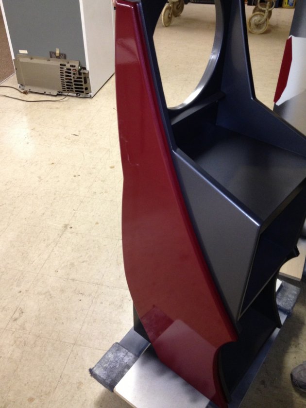

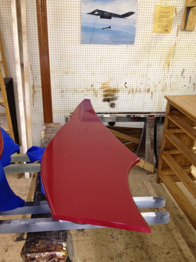

No painting for me.
Waiting to hear from Skiing Ninja when he might be able to do the red finish.
Easy enough to remove the drivers and wiring when that can happen.  Until them MDF brown will work.  No WAF in my listening room!

jparkhur
Hopefully he will paint them with car paint..Shiny, glossy, Gary's turned out well when sprayed with reducer.. or spray bed liner....

HAL
  • Industry Contributor
  • Posts: 5584
The idea is to get them finished in Ferrari Red with racing stripes at some point.  Skiing Ninja has access to the correct color paint.
