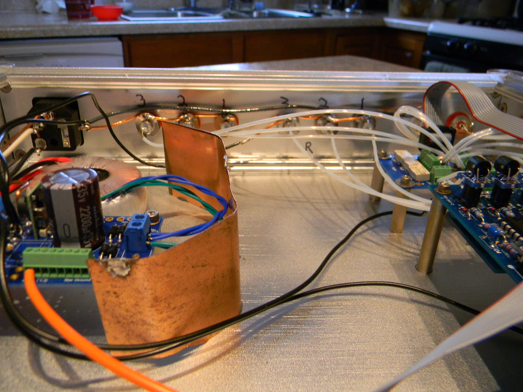

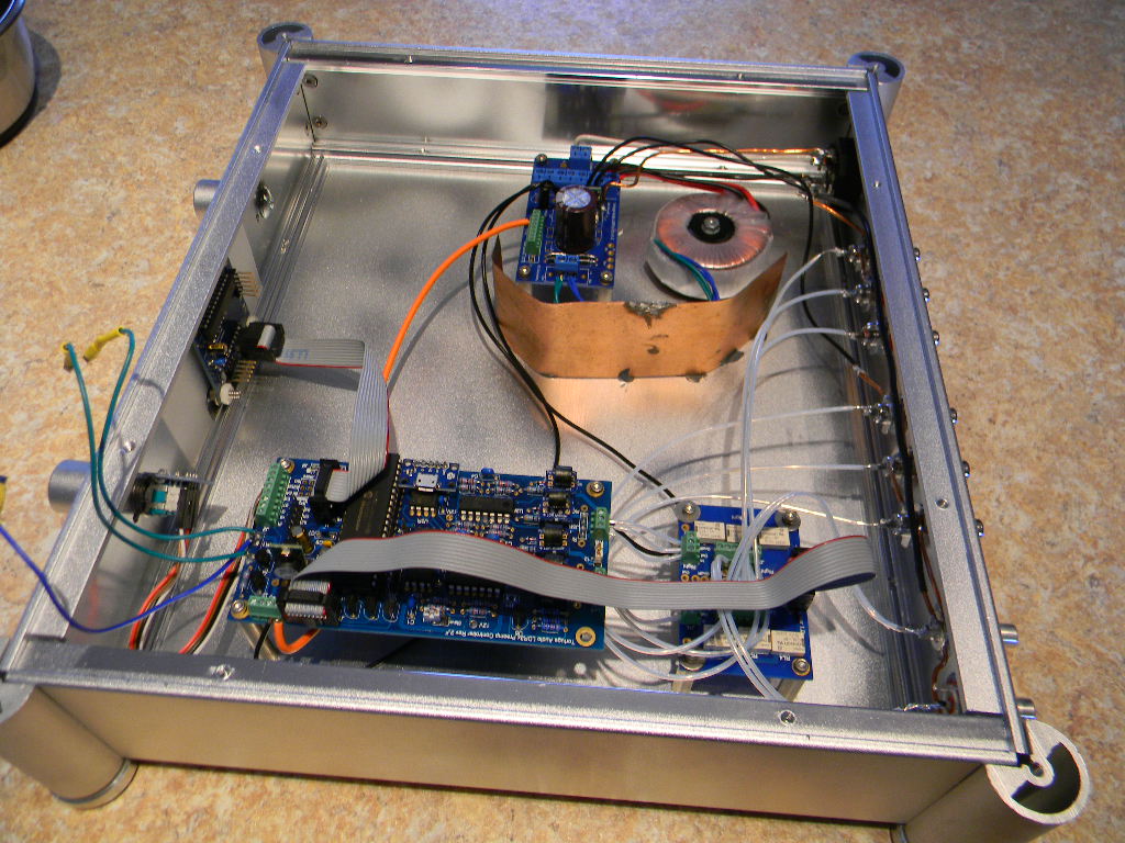

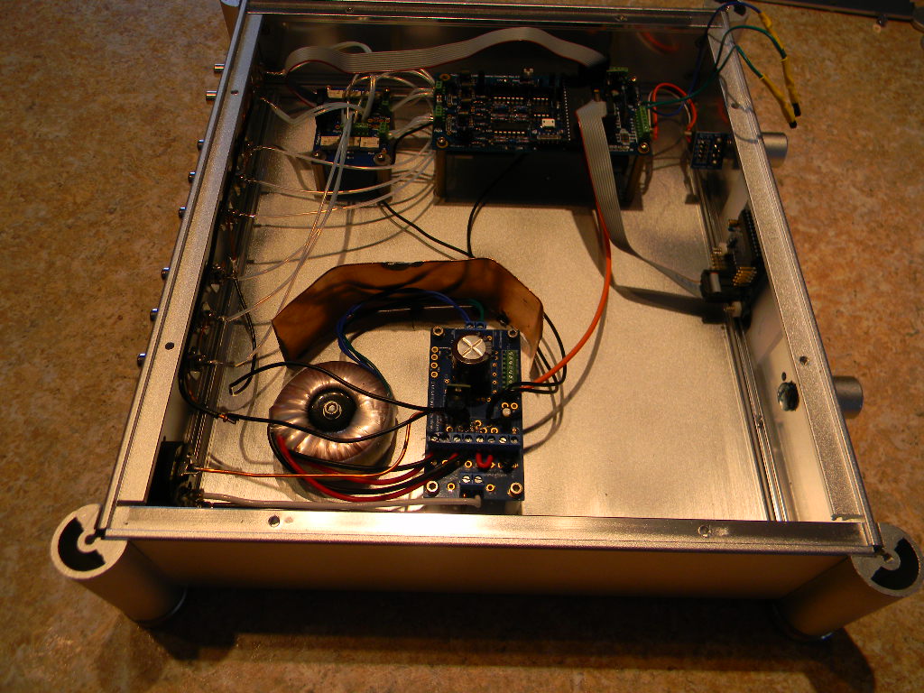

I still have some noise, seems to be picking up the computer and makes a whine independent of the volume setting.  Otherwise it sounds pretty good.
This is my content:
LDR3x.V2 Passive Preamp Controller
DM1 Display Module
board-type: single-display-master,
ldr3x-firmware-update: none,
DM1 Colors: Blue
IO3 Relay Board
PS12.5 Power Supply
ps12-options: 12v-400ma-single-channel
Apple Remote
Encoder Module
Cardas RCA Jacks

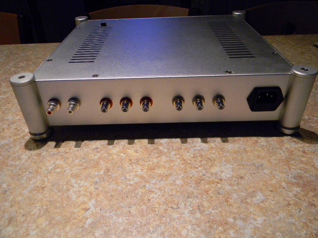

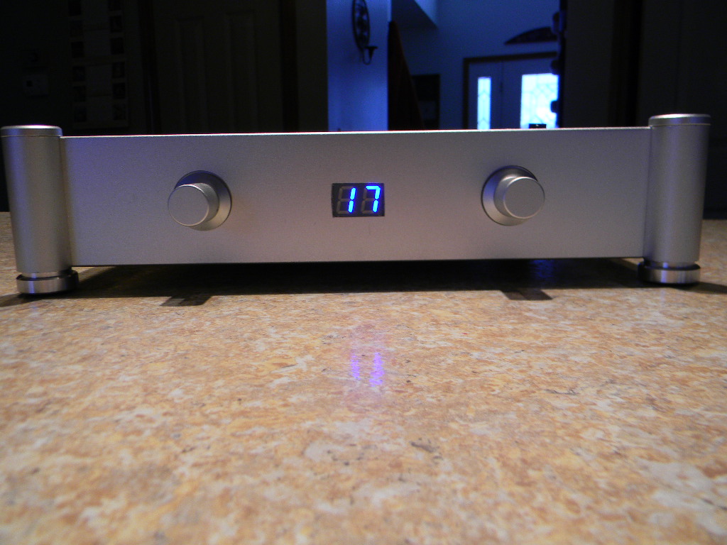

I added the Chinese case, a HiFi Tuning fuse, solid silver wire in teflon, silver plated output RCA's, a small token copper shield.
I have the remote receiver poking out the top slightly.  The unit is not perfect.  Some small knicks and bruises here and there.  The right knob is the encoder and the left knob is a fake.

In my case, suitable grounding made a significant improvement. If I may suggest, it is better to use plastic spacers to fix the LDR board to the metallic enclosure to avoid ground loops. Also, the copper shield must go through the entire enclosure to separate the PSU from the rest. Even better is to have the PSU in a separate enclosure. I also had an itch :)
Well the corner pads are not a ground plane and are not connected according to my meter, but I went ahead and installed nylon washers and screws to isolate them.  Unfortunately the unit will not power up so I cannot check the grounding.  Have 12 volts to the main board but after that, nada is happening.  Frustrating.

Weird... is it really due to the nylon washers and screws? Is it possible that the 0V is not arriving for some reason to the board, and so the corner pads are taken as reference 0V?
-R
tortugaranger
  • Posts: 1779
    • Tortuga Audio
Re: Finished the build
« Reply #10 on: 1 Dec 2014, 03:37 pm »
After talking to Pete about this on the phone I asked him to send his V2 and DM1 boards back so I could check them out. Current working theory is the display board may have been shorted out due to mounting with metal washers that may have bridged between chassis and parts of the display circuit but like I say, that's just a working theory. The V2/DM1 work very reliably together but shorting either can lead to problems. I will take me 5 minutes to diagnose and will report results. To date I've not had a single display module go bad but there's always a first time.
To follow up on this thread, when I received the V2 and DM1 boards I hooked them up and applied power. Whad'ya know - nothing happened - just like Pete described. After some inspection I discovered the problem.  The JP1 Slave jumper was indeed jumpered. This tells the V2 board that it's a slave board and so it waits for input from a master V2 board and in this instance there isn't one. Thus nothing happens. Pulled the jumper and suddenly everything works normally.  :thumb:
