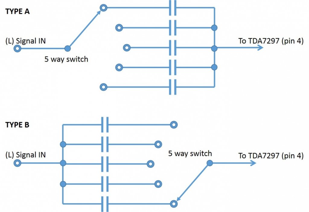

I'd like to test different input coupling caps with TDA7297, and wanted to use 2 pole 5 way switch to switch between the caps to be able to hear them side by side, without having to reconnect/resolder anything. I'd like to know whether Type A or Type B configuration would be preferred - see the diagram below. Or there would be no sonic difference between the two?
Or is this entirely bad idea and there would be too much interaction and interference between the caps in such configuration that it would NOT make a realistic comparison test?
Thank you,
Rado

The PCB board that's part of the kit has holes and a long pad for rolling film caps available from places like Mousse. It's not big enough for teflon caps, but almost nothing made is; they're always mounted a bit funny since they're enormous.
