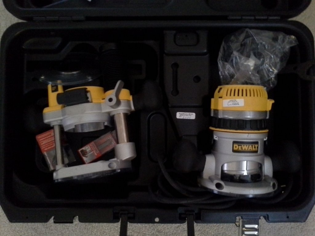

Use a Dewalt plunge router. (Experiment with some scrap wood, until you can get a grasp on how to control it. Seriously. )

« Reply #12 on: 18 Nov 2014, 02:34 pm »
That's the same kit I've got. Wonderful machine.  :thumb:

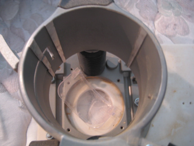

Okay, here’s the deal with my Bosch router. As a machinist, I don’t like the way Bosch only cleaned up/machined 3 small places for the motor to slide into.
The Porter router I looked at after purchasing my Bosch was completely machined on the inside of both bases for the motor to fit/slide into.
Bosch went the cheat route IMO but I ordered it online without seeing it.
Wish I had a pic of the inside of a porter.
Much better construction.

« Reply #19 on: 18 Nov 2014, 11:06 pm »
Now this I understand.  :thumb:
I'll check every model. Perhaps I'll take stealth photos of each to post here.
