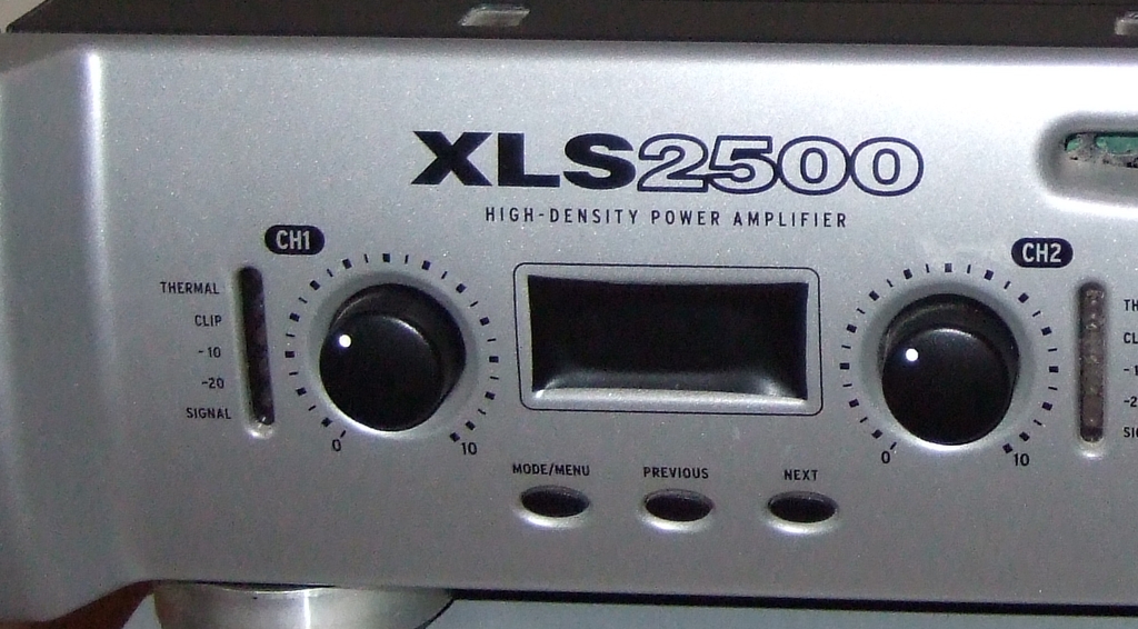

After you have set the options how you like, the amp can be made to look a bit better by this "black tape" mod: You can see a bit of one Sims Navcom Silencer under the front left of the amp in the pic. Sims now makes archery products and it's possible some could be used as amplifier feet. If you search EBay for Navcom or Limbsaver Broadband you will see some stuff like that.

I'm actually more curious if I'll like it over my prototype 7297 board I can tell you this... First it's clear that there might be a couple key re-cap areas in the front end. The recent OSCON flavors from Panasonic and Nichicon are like they're canning bits of God and attaching leads. I really don't like the diode bridge in it. But we'll see. If there's an easy way to isolate the RCA's from the safety ground that might be a nice improvement. It depends on a few things. It appears to run on very high voltages, so there's serious limits towards the amp section and changes. Also it's a SMPS with PFC to DC to DC conversion. I prefer linear, but that's not a "mod", that's like a revamp requiring so much effort I should just work for Crown to make an Audiophile version. Well, perhaps. The PFC section is straight rectified 120v. Unfortunately I'd say that it's not for sound, and more just for compliance. I'm sure outboard PFC would benefit the amp, baring a radically different PSU. The upside is that it already sounds so good!
There's one mod that should be blatantly better. Luckily it's pretty cheap. However it could even already be done and I don't know... Oohhh mystery!
....Also it's a SMPS with PFC to DC to DC conversion....
You've confirmed that the switching supply on the ZLS is using active power factor correction?Could you give me a reference please?Thanks in advance,Paul
