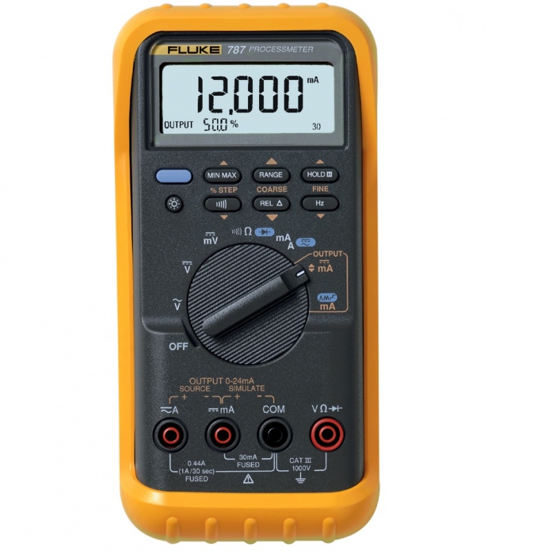

Fluke makes great equipment. I have one of their DMM. There are probably cheaper alternatives, though.
I bought a used Fluke 78 III off eBay a few years back. Very reasonable. Looks very similar to 787 model below. Best meter I've even owned. Eats batteries though. Then again I use it most every day.

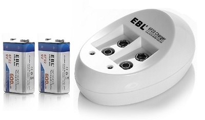

Would 8.4V work?  2 X 9V 600mAH Li-Ion + charger (recharge 1000 times) for < $15.
Looks like a winner! (for the Fluke)
