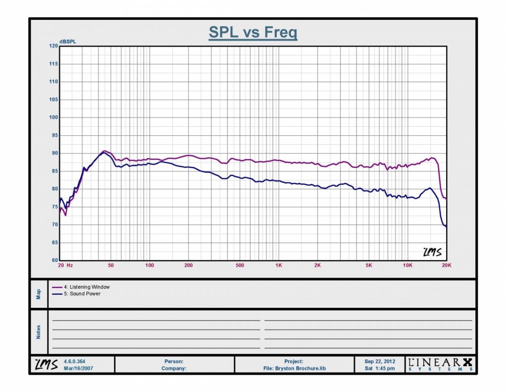

Here is an excerpt from my white paper on our speakers and give s a better explanation of my thoughts on speakers and room interactions:
BACKGROUND:
The two most critical parts of any loudspeaker system choice is the listening ‘ROOM’ and the loudspeakers‘POLAR’ response. Recognizing how the room imposes its boundaries (floor, ceiling, walls) on the speaker and how that speaker radiates its energy (polar response) into a specific room is critical to the understanding of the overall performance of any speaker and it is no different for the Bryston Model T loudspeaker.
When you are listening to a loudspeaker in a room you are always listening to a balance between the ‘Direct Sound’ and the ‘Reflected Sound’ from the boundaries of the room – this is called the ‘Power Response or Sound Power.’ It is that balance between direct and reflected energy which changes depending on the frequency radiation pattern (polar response) of the given speaker and the boundaries of the room the speaker is placed in. Dipoles, Bipolar, Omnipoles, Direct Radiators, Horns etc. all behave differently due to their specific radiation patterns and therefore exhibit different power responses in any specific room. Bryston has chosen a direct radiator approach in the design of the Model-T loudspeaker for numerous reasons but one critical reason is because we feel it is currently the best way to accomplish the correct balance between direct and reflected energy in real world listening rooms.
DIRECT and RELECTED SOUND:
The ‘direct sound’ is the sound radiating from the front of the loudspeaker and the ‘reflected sound’ is all the sound your ears perceive after the sound waves have interacted with all the different boundaries in the room. It is important given real world conditions that the on axis response and the off axis frequency response of a loudspeaker be as uniform as possible. This on and off axis characteristic is generally referred to as Polar response. The smoother and more uniform the on and off axis polar response of the speaker the better the tonal balance between the direct sound and the reflected sound will be. In other words, the reflected sound will have the same overall tonal balance and sonic characteristics as the direct sound if ‘on and off’ polar response is smooth and even. This approach also provides the optimum overall 3-dimensional soundstage presentation as well. The Bryston Model-T is a very wide dispersion design so the polar response is very flat on axis and very uniform all the way out to more than 45 degrees off axis in both directions from center to provide a very wide and even listening window.
LISTENING WINDOW and SOUND POWER:
In a loudspeaker the ‘listening window’ is an average of a front set of curves whereas the ‘sound power response’ is an average of all the curves right around the whole speaker. What we actually hear seems heavily weighted to be a balance between these two conditions. The listening windows frequency response should be very linear (flat) across the entire audio band but the sound power should fall off by 8 – 10dB by the time you get to 10kHz (see diagram below) while still remaining linear in its march down from the bass frequencies.
Striking the proper balance between these two is extremely important to the sound of the speaker. Keeping the listening window and the sound power both linear is not an easy task and is where most speakers fall down.
Typical Model-T Passive Anechoic Response
Typically there is a lot of attention paid to the linearity of the direct on-axis frequency response by reviewers and knowledgeable consumers but it is really just one curve in the mix of 64 curves Bryston utilized in the design the Bryston Model T passive loudspeaker.
Freo-1
