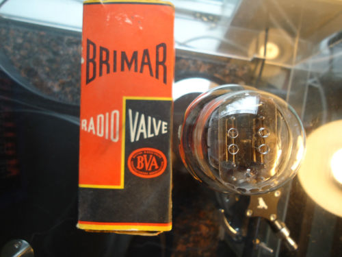

Finally heard a 6A3 I like.  A pair of BRIMAR, made in England 6A3 tubes.  A bit more forward in the mid range than the 275As, but still a really nice sound.

Where did you find those 6A3s?

Pic please. I have a pair of vt52 an equivelent I think. No cap on top do yours have a cap ?

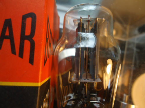

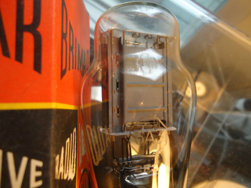

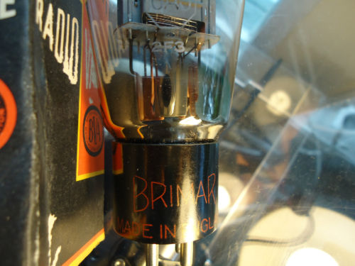

I have VT-52s and 6A3s.  This is looks like two VT-52s sandwiched together.  See the pics (not mine).

Thanks I might have a pair. I'll see tonight
They do look familiar but it could be the color as in rca or something.
I'll post a pic of mine as well
