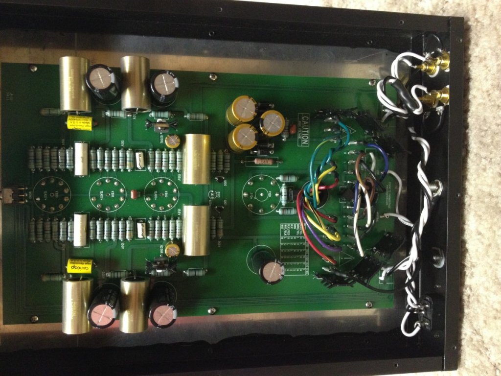

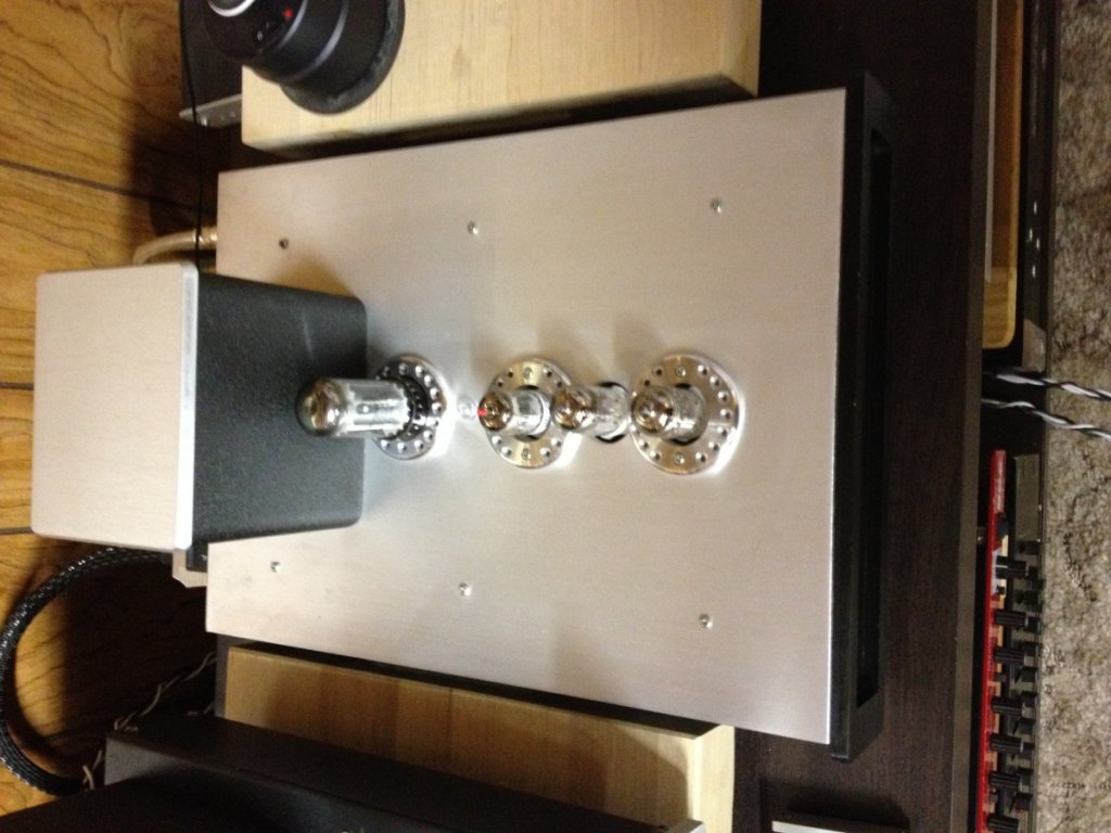

Hello all.
Sorry for the delay.  I have been busy tweeking the Cornet2 over the last few days.  Twisting wires, checking grounds.....  I did find that I had to lift the ground on the power cable that feeds the C2 to try and reduce hum.  This had some effect at reducing things, although I know this is not the best fix.  I will be adding some shielding and different wires for the inputs and outputs.  As promised here are the pictures of my C2.  Thank you Jim and Poty for all the help getting my C2 sorted!

« Reply #16 on: 16 Oct 2014, 06:38 am »
I'd not risk the safety disconnecting the safety ground from the chassis. Reducing hum in this case means some ground loops somewhere, probably in the next device in the chain too.
Marvelous look!  :thumb:

« Reply #17 on: 16 Oct 2014, 01:09 pm »
Hello poty.
Thank you again for your comments.  I will be reinstalling the ground on the C2, and replacing and shielding some of the wiring.  I am sure that this will resolve the hum problem.  Thanks again!  I would love to see pictures of other C2's if anyone would like to post them here.
