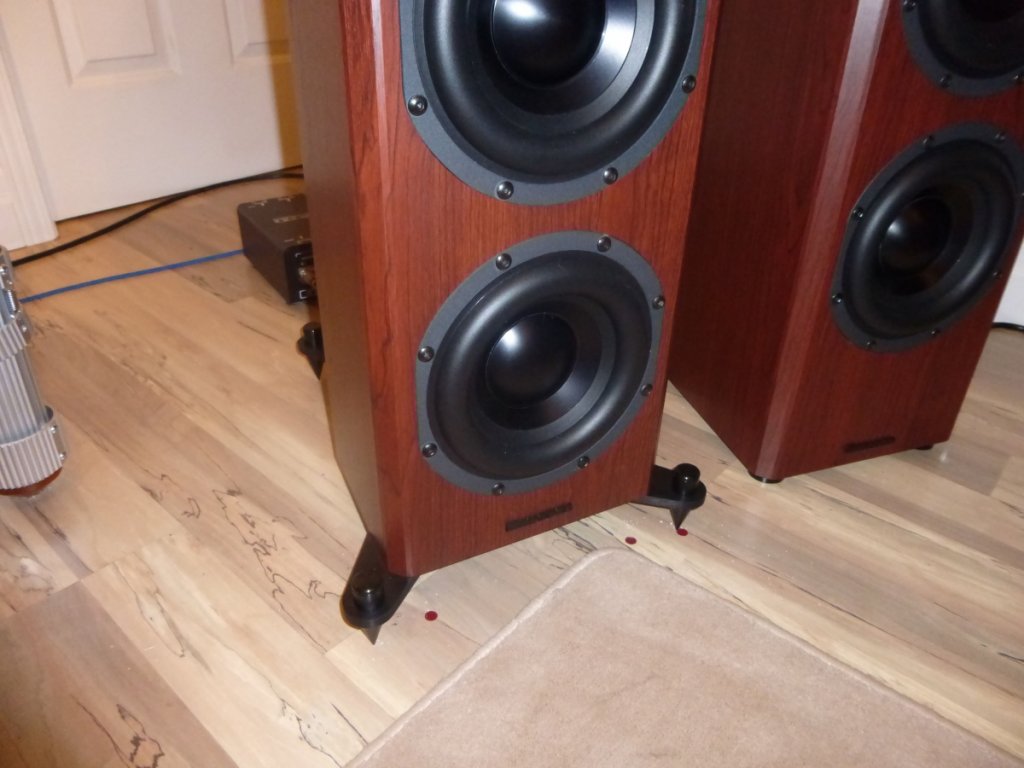

Hi Rich
Here are the XL versions of the Outriggers for the Model T's in my setup at home.
james

Hey James is that blood on the floor at your speakers? What did you drop the speaker on your toe?
 :lol:

« Reply #32 on: 5 Sep 2014, 10:28 am »
 :lol:
LOL - no werd its the red stickers I use when I move the speakers in and out for evaluation and want to make sure I am using the exact same location.
james
james
James,
Is that the rosewood finish in the foreground?
James Tanner
  • Posts: 21004
  • The Demo is Everything!
    • http://www.bryston.com
Re: Should I use spikes on my loudspeakers?
« Reply #34 on: 5 Sep 2014, 09:00 pm »
James,
Hi
No it is the Boston Cherry Finish - looks a lot like Rosewood though.
james
