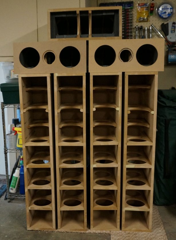

Am finally building the speakers for my niece, nephew and step-daughter.
The niece and nephew each get a pair of X-MTM Encores and my step daughter gets the three (L/C/R) X-CS Encores on top.
The X-CS Encores have the NoRez installed. One more baffle to glue on and they will be ready to prep for the veneer. The MTM's are ready for the NoRez.
The veneer is on order. The step-daughter wanted Wormy (aka Ghost) Maple and the niece and nephew are both getting Poplar which will be ebonized.

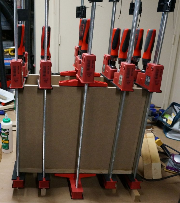

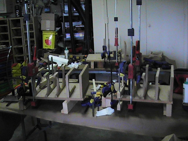

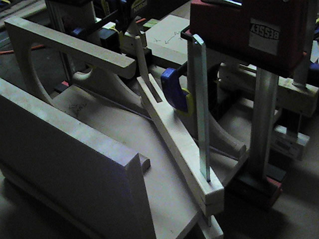

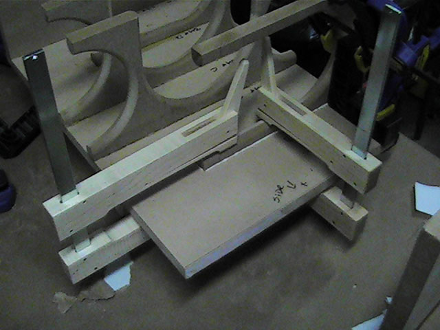

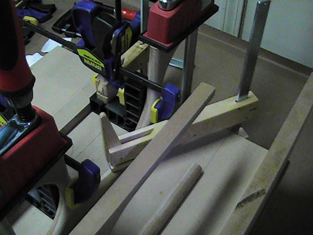

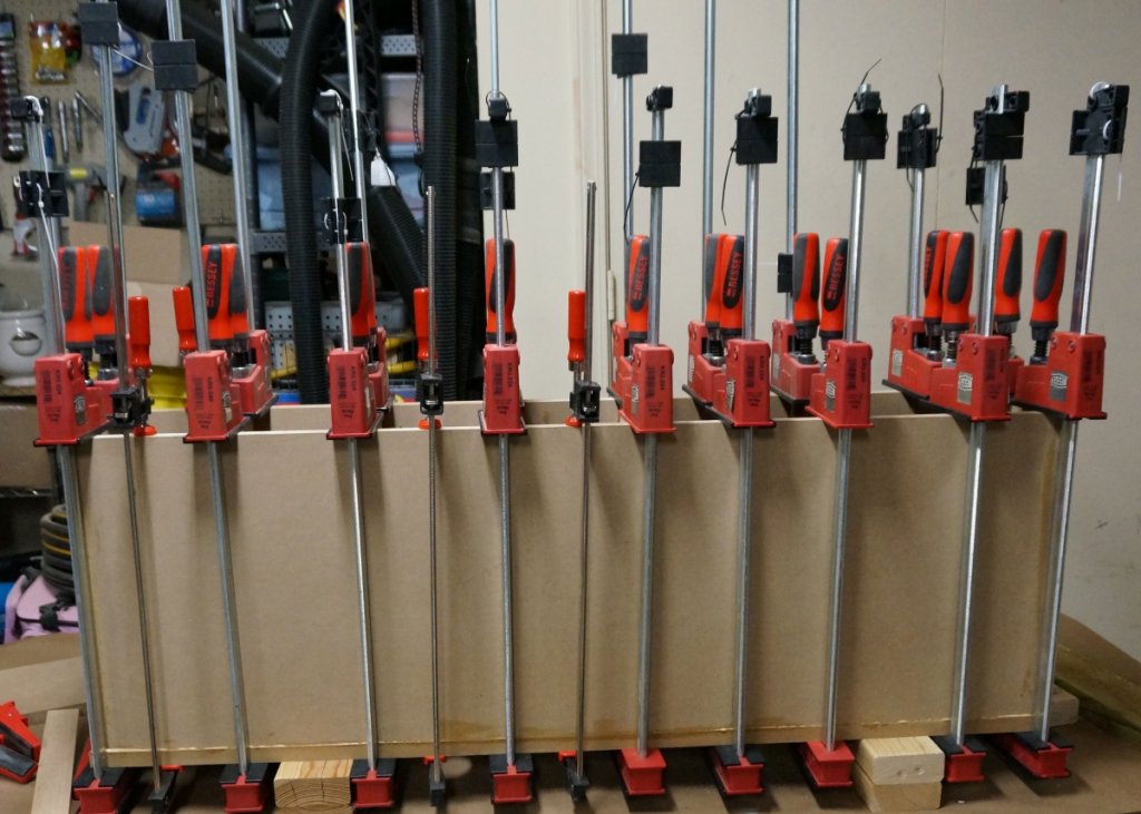

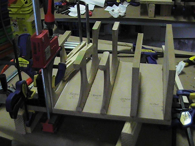

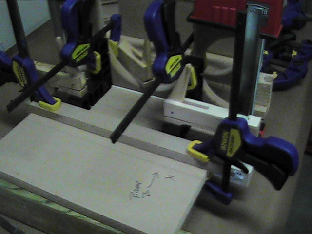

Here are some pics of the X-CS Encore glue ups. Those Brace B's are a bugger since they are recessed far enough back that none of my clamps would reach them. I had been using a brad nailer to hold them in place until the glue dries but that had some problems, mainly splitting the MDF. Maybe a pin nailer would have worked better. Then I came across some wooden cam clamps with 6", 8", and 12" reaches. They didn't seem real substantial even though they supposedly applied 350psi clamping pressure.  I had read about them being used by guitar makers so I decided to give some a try.
Check them out in the pictures below. They really work well and reach where no other clamp will.
Here are some more pics of the braces going in:
The top being glued on - new camera, bad exposure
Now the back
That's all for now, more to come
Mike

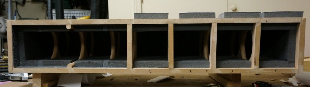

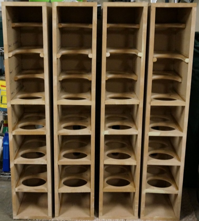

Here's some pictires of the X-MTM Encores. Gluing up the back of one of them here
Here's all 4 of them ready for the NoRez

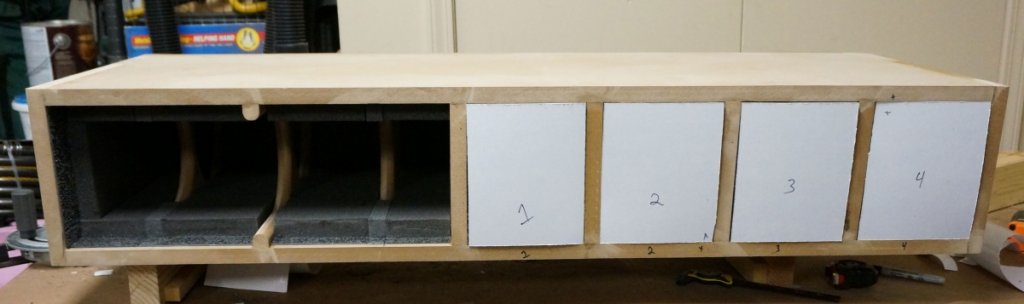

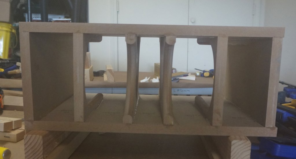

Started adding NoRez today. Here's the first one, fully lined
Here it is again with the pieces in place that will attach to the front baffle
Had a little surprise with the NoRez. I bought 4 sheets, 1 per speaker, when I ordered the kit. I couldn't find any pictures showing me where to put the NoRez in the MTM Encores so I just lined everything. The surprise? One sheet wasn't enough. It took 2 1/2 sheets of NoRez to line this speaker. I only have 1 1/2 sheets left so I am going to have to get some more after the holidays to finish up.
Mike
