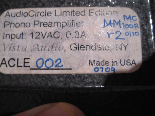

Hi Boris, AC members,
 What do the marking in ink pin mean on my Vista ACLE phono preamp.
I bought it used a coupe years ago and don't know what it was originally setup for.
Seems to be working great with 5.0mv MM cartridge's.
Steve

« Reply #1 on: 18 Aug 2014, 01:29 pm »
Hi WireNut,
I'm very glad to hear that the preamp is working great for you! :thumb:   I just realized that it's been just over 5 years since it was first introduced, how time flies...
Markings on the label were put by me. Originally the preamp shipped set for an MM cartridge, then, several months later, it was reconfigured for an HOMC cartridge with 100 ohm loading.
I hope this helps!
Boris

« Reply #2 on: 18 Aug 2014, 03:06 pm »
Boris, Do you think my Vista would work "as is" with a Dynavecter MC 10x5 which has 2.5mV outputs. That will probably be my next cart upgrade.
I'm currently using a goldring MM cart with 6.5 mV output, or, an AT120E WITH 5.0mV. I have plenty of volume to spare on my tube preamp.
Steve
Audiovista
Re: My Vista ACLE unit specs
« Reply #3 on: 19 Aug 2014, 12:05 am »
Hi Steve,
When setting preamp for Dyna 10X5, I was going with 1k load. You will probably have enough gain, but 100 ohm load may give you a "muffled" sound. However, as the preamp works well with your MM carts, I wonder if somebody returned it to the default state (47k load). In that case sound will be on the bright side but, depending on the rest of your system, it may sound just right. In any event, once you get the new cartridge and if you are not satisfied, it will not be difficult to optimize the preamp for it.
Best Regards,
Boris
