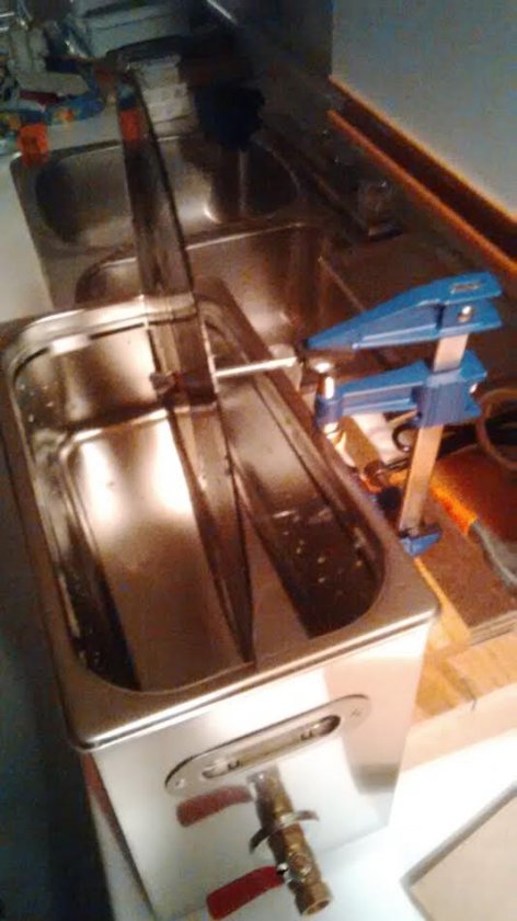

Well I rigged up a little stand and spinner with some wood clamps and a screw. I just cleaned 2 records. Pink Floyd Obscured by Clouds and The Carpenters (they are my guilty Pleasure). Both these records have been cleaned with my DIY Vacume Machine but I knew they still have some noise. Before I cleaned each record I listened to two songs, taking note of the background noise and clicks and pops. Definitely and improvement in background noise. Definitely and improvement with clicks and pops.........much much cleaner. I can not say the click and pops are gone because they are not. They have be reduced significantly.
I know this is by no means a thorough comparison.
I am listening to the Carpenters as I type and am a little shocked how much better it sounds.
I used Distilled water and 240ml of Isopropyl alcohol and Dryed the records with my RCM.

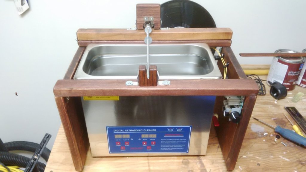

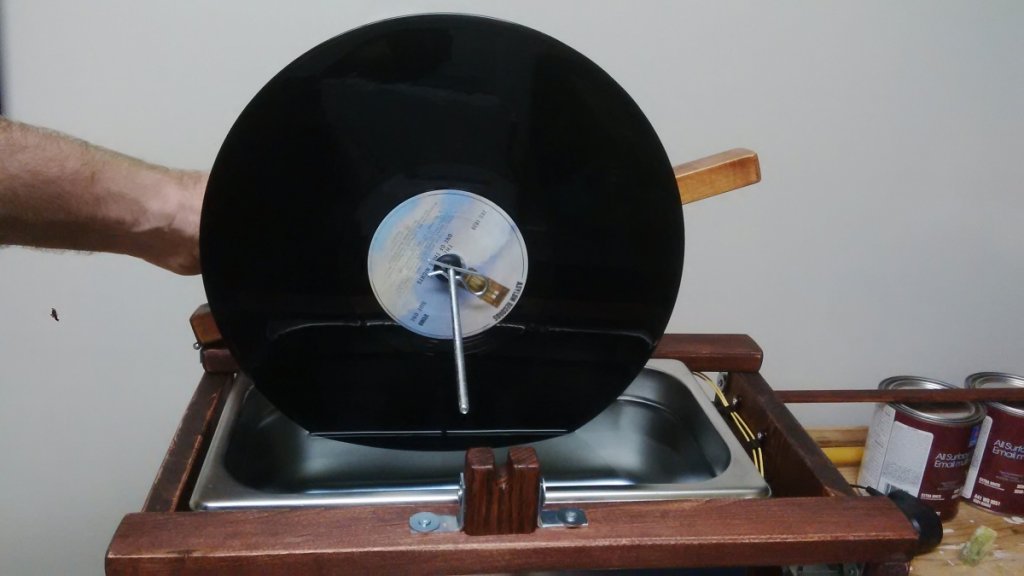

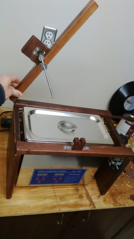

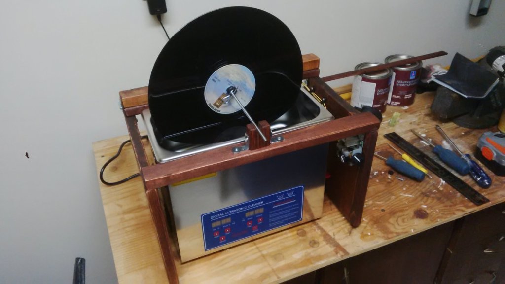

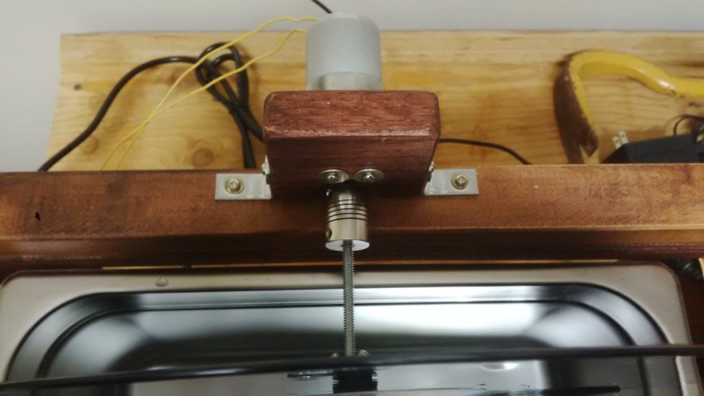

I have been working on for the past week and final finished. It turned out really nice and works perfectly. I had to buy the motor and motor control from a local hobby / electronic shop and  I had some wood kicking around the work room.
I kinda copied a design I found online but tweaked it to my preference. Mainly I wanted to be hands free when I add and remove the records. That is where the back arm lifts with the motor attached. I still need to make the mechanism to hold the arm up when raised. Another challenge was holding the records on. I could not find an appropriate clip to hold records on with a smooth metal bar so I had to go with threaded rod and wing nuts. Then I realized it was taking me too much time and effort to screw and un screw the wing nut onto the rod. So I came up with using the cotter pin. Works well for now but I will be on the look out for other options, if anyone had ideas, please let me know.
Looks good!
Could you list the motor and controller brand and model numbers?
It would be nice to use one that has already been tested, instead of having to 'reinvent the wheel'.
Thanks!
undertowogt1
Re: DIY Ultrasonic album cleaner
« Reply #98 on: 14 Nov 2016, 09:57 pm »
Looks good!
Thanks!

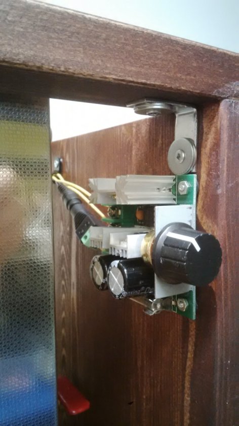

Sure. I really didn't know what I needed for the motor and controller but it was pretty straight forward once the dude at the store gavve me what I needed.
The motor is
37D  131:1
80 rpm   0.3A    s:5A   250oz -in
(at the slowest point it goes around 3 rmp. at the fasted it goes like 80 or something)
The motor controller is
PWM 10A
AMS12402P     10-100%  13k
not sure if this helps, but that what the packages say. I dont have brand names to go by for these.
