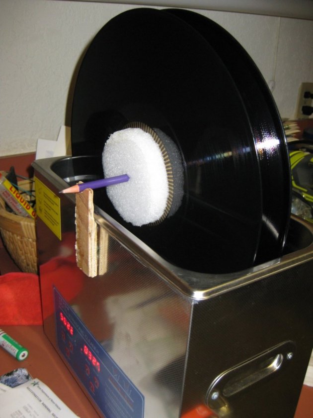

Ok, it's been about a month since I've put this together with hot glue, a Whataburger malt straw, a promo pencil, $126 U-sonic cleaner, and an $8 dollar rotissarie motor.
I've probably cleaned 50-75 lps.  No doubt, it works and produced a quieter lp than standard VPI type cleaners. I usually set the timer at 3 minutes, sometimes 4.  I've filtered the solution three times without noticing any vinyl residue (I suspect that most of what comes off is tobacco smoke and dust).  Eventually I'll do a controlled experiment with vinyl and take microphotographs, but honestly I think Ill be wasting my time.  It doesn't create any audible degradation, and the cleaning is superior to  standard vacuuming.  For under $150.  Any questions?
The dog still can hear it and can't stand it.  He has to go in another room.

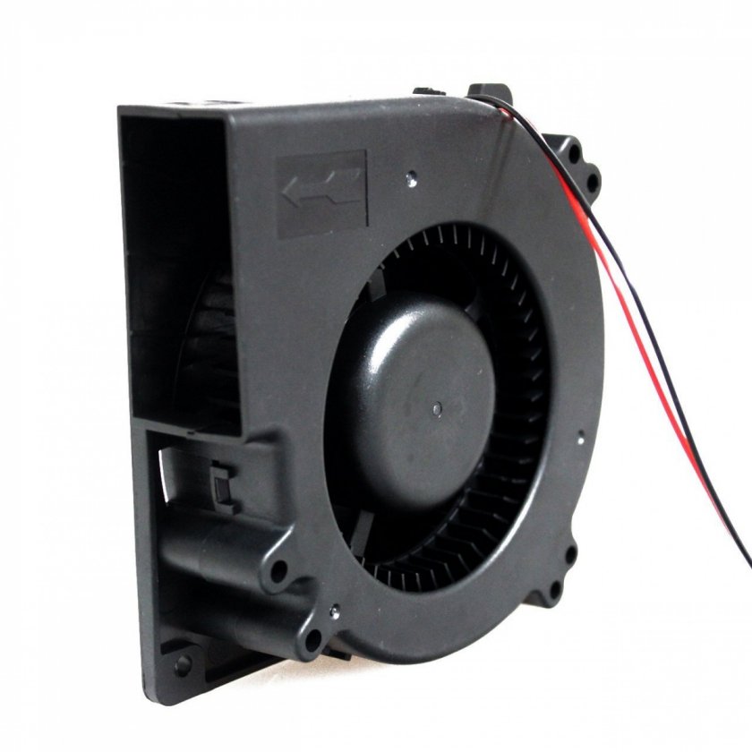

How about attaching a blower, so instead of going to s typical vacuum machine,  we can use air to blow the liquid off.  Like at the end if a car wash.
https://www.amazon.com/Brushless-Radial-Blower-Centrifugal-4-72x4-72x1-26/dp/B01CSNEO2G/ref=sr_1_79?ie=UTF8&qid=1465957368&sr=8-79&keywords=blower+fan

The blower should work quite well, especially if you could rig the rotisserie motor to turn the lp while the fan dried it.
TomS
Re: DIY Ultrasonic album cleaner
« Reply #36 on: 15 Jun 2016, 02:49 am »
I'd think a blower, while certainly removing fluid, would also draw any ambient dust and particles in and deposit them back onto the record surface.

I agree.  Either a spinner or a vacuum would be the best solution.

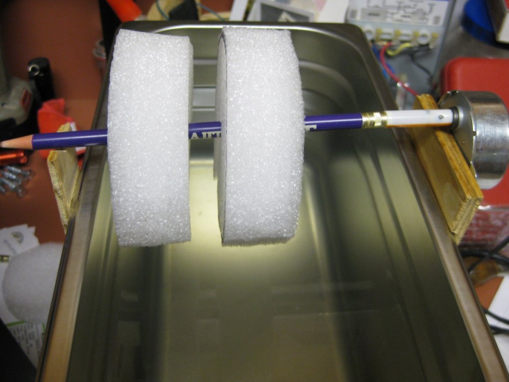

Here is a pic of the fit of the shaft into the connector (pencil & straw)  The spacers are the closed foam packing that came with the cleaner.  I figure that a wavelength of about 3 cm was needed for 60 KHz in water.  It's not exact since I didn't account for the alcohol, which should lengthen it a bit.

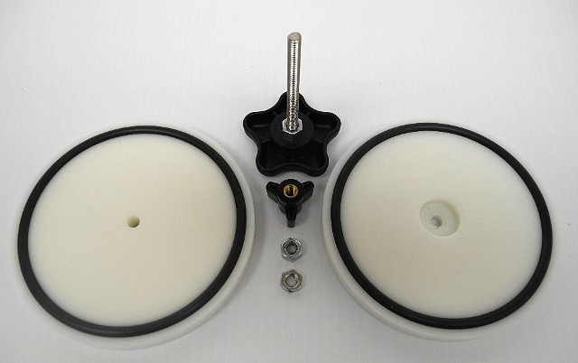

Are these just standard pvc fittings?
