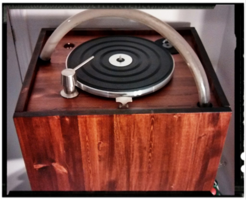

undertowogt1
Re: DIY Ultrasonic album cleaner
« Reply #176 on: 26 Mar 2017, 02:34 am »
S Clark or anyone else for that matter - A picture is worth a 1000 words, do you happen to have a picture of your vacuum set up?
I have all kinds of ideas about how to go about rigging up a vacuum system, including connecting a shop vac hose to some sort of a mount.
Would love to see some ideas here. I'm a great copier of good ideas!
After I do the ultra Sonic Cleaning I keep the 2 remaining records spinning in my solution while I vacuum the first record. This is a small shop Vac in a wooden box with a motor turning a turntable, It can go in both directions. This was my DIY cleaning machine before the DIY Ultra Sonic. Now I just use it to suck up the water after Ultra Sonic Cleaning. No more pushing the dirt deeper into the grooves.
