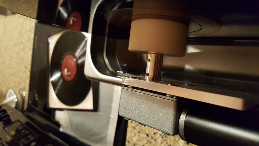

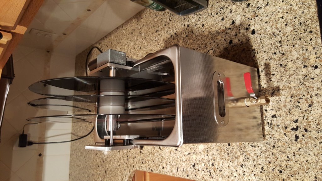

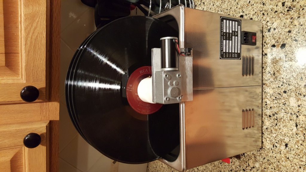

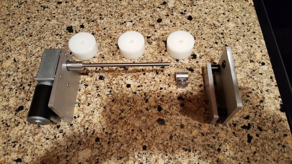

I haven't been on AC in a while and happened across this thread, I built one of these recently as well. Since I have a home machine shop I took advantage of it. A 90* worm drive motor from fleabay and the standard 40kHz tank. I had the rest in various bins. Very happy with the results thus far.

Thanks for the kind words. Certainly wasn't expecting any requests. I'll think about it, my machines are not CNC but once set up it's pretty quick to cut all the pieces. One thing I am going to change is the motor, the one in the photos is 8 RPM at 12V DC, I am running it of some old Casio 5V power brick I found in a box, so perhaps 3.5 - 4 RPM, which is OK but I ordered a 2 RPM unit and it arrived yesterday. It's also 12V, so if run on 6V it should be 1 RPM, either way, I think a little slower is better. The downside is that it's considerably smaller and will require a new mounting plate but I have a lot of 1/4 AL plate so not a big deal. It will also need a different size shaft coupling, 6mm vs 8mm but that's easy enough.
I'll think about what materials will cost, if I make some mounts you would have to source the motor, of course that's easy on ebay.
