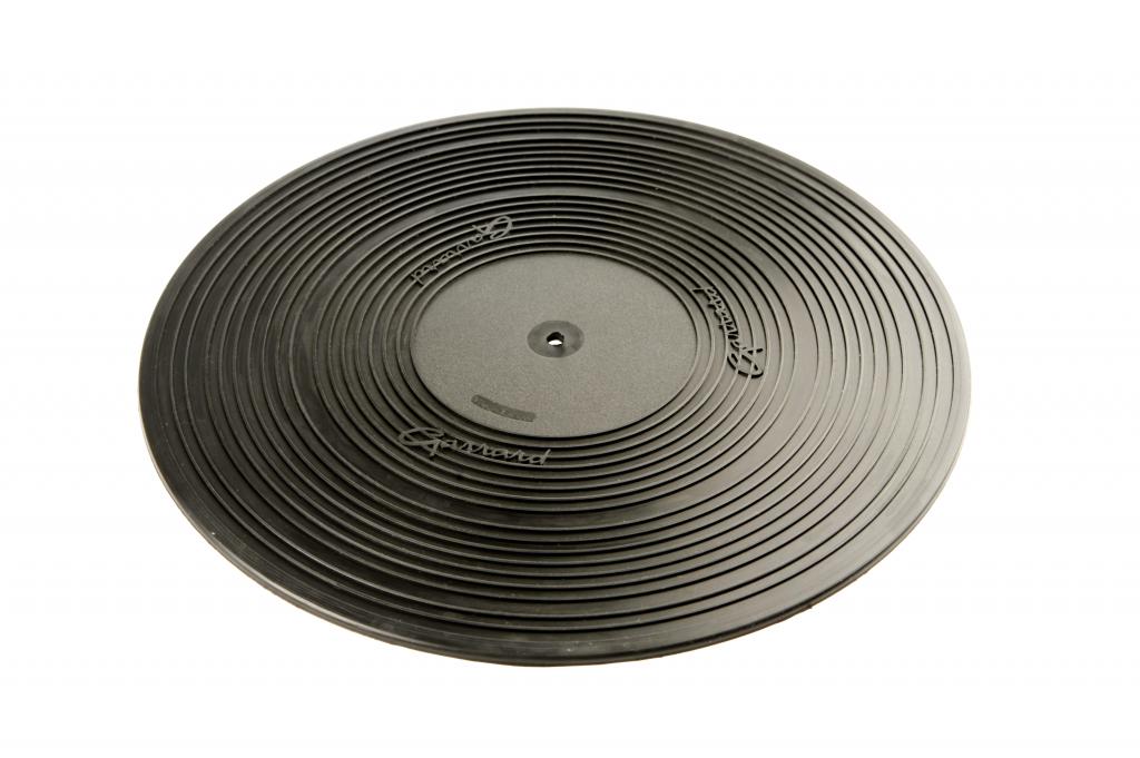

Quick question: how do you use a vacuum machine to dry it, when both sides are wet? ...doesn't that just make the platter on the machine wet when you flip it over?
Good question, I realized that it might be an issue as I was cleaning my first record. Turns out it wasn't a big deal though. On my DIY cleaning machine I have a rubber turntable mat similar to the one pictured. Just the ridges of the mat get a little wet and it is not a concern for me.
