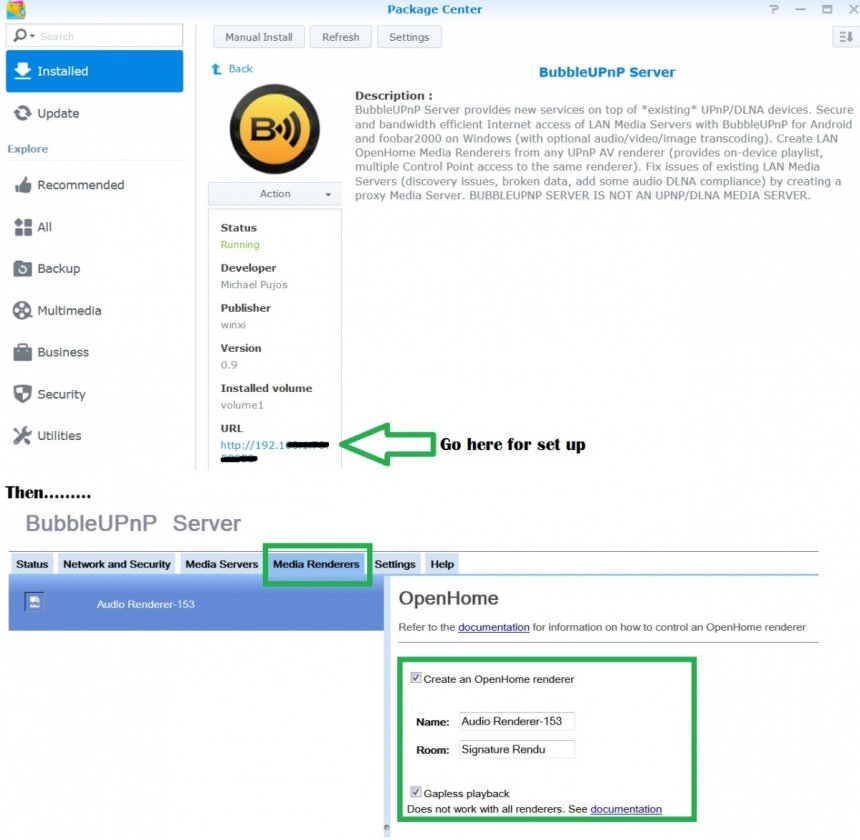

This is a screenshot from the Synology (and then the Bubble URL setup screen), after I installed Bubbleserver.  I'm sure the Qnap has a similar section.

In BubbleUPNP Server I recommend that you name the Room as Signature Rendu-OH so you can tell things apart.
